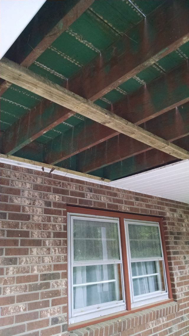

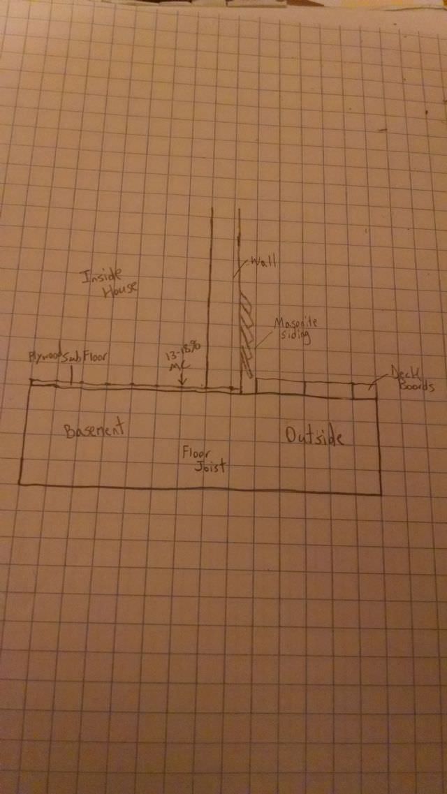

shwagy357 Posted July 9, 2015 Report Share Posted July 9, 2015 I am planning on installing ?? hardwood floors in my single level home with basement. The hardwoods will be installed above the basement level. As part of my preparations I have been taking moisture readings. The moisture content of the 1/2" plywood subfloor is mostly 8%. However along a certain exterior wall I have had readings much higher 13-18%. The partcleboard I removed along these exterior walls was not wet. Just outside this specific wall a deck ties into the house. Please see the attached sketch. Note the floor joist run continuously from inside the basement to outside underneath the deck. The exterior edge of the subfloor is exposed to the outside. What would you do reduce the moisture seen inside the house? Quote Link to comment Share on other sites More sharing options...

shwagy357 Posted July 9, 2015 Author Report Share Posted July 9, 2015 Click to Enlarge 78.38 KB Click to Enlarge 40.31 KB Quote Link to comment Share on other sites More sharing options...

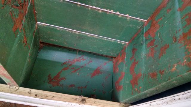

shwagy357 Posted July 9, 2015 Author Report Share Posted July 9, 2015 Click to Enlarge 124.46 KB Click to Enlarge 38.01 KB Click to Enlarge 16.76 KB Quote Link to comment Share on other sites More sharing options...
kurt Posted July 9, 2015 Report Share Posted July 9, 2015 From what I'm seeing, there's no flashing or water management details anywhere....not on the deck, the window, the sills, the rim joist/subfloor....nothing. My WAG is the lack of flashing anywhere is allowing incidental amounts of water, in multiple locations, to enter the walls. The water dissipates out into adjacent materials creating the readings you're getting, which aren't all that bad, not bad enough to make stuff look or feel wet, but they're enough to give you elevated moisture levels and enough to mess up a wood floor. The readings don't provide a smoking gun to a single source; they're like what I find in simple boxes lacking flashing anywhere. Quote Link to comment Share on other sites More sharing options...
Marc Posted July 9, 2015 Report Share Posted July 9, 2015 The deck members should be flashed where they connect to the house to keep moisture out. If the floor joists are the same members as the deck joist then there is no way you can do that properly. In your case the joists are conduits that bring outdoor moisture into the house. I'm not saying you can't install your hardwood floor, just that there isn't much you can do to lower the moisture levels in that area, short of rebuilding the junction between house and deck. What Kurt said. Marc Quote Link to comment Share on other sites More sharing options...
Garry Sorrells Posted July 9, 2015 Report Share Posted July 9, 2015 Arden, If the sub floor is 1/2" you have a problem right there. The cantilevered deck joist may be wicking moisture back into the garage and causing the elevated moisture levels, then add onto that any lack of flashing and sealing of the deck from the house. Quote Link to comment Share on other sites More sharing options...
Jim Baird Posted July 9, 2015 Report Share Posted July 9, 2015 ...Marc and Gary's comments are based on the idea that a piece of wood, on very small scale, is a bundle of tubes, which offer migration paths for moisture. Quote Link to comment Share on other sites More sharing options...
David Meiland Posted July 9, 2015 Report Share Posted July 9, 2015 I've repaired lots of situations like that where the floor joists are cantilevered out of the house to become deck joists. There's almost never any flashing over the joists, and when there is, it's a piece of 1-1/2" x 1-1/2" 26-gage angle nailed to the wall above the joists, with one leg sitting on top of them. Woefully inadequate, and in any case, you probably don't even have that. When I've had to build cantilevers like that, I've had a sheet metal shop make individual flashings for each joist, with flanges on the wall and hoods protecting the top and sides of the joist. Quote Link to comment Share on other sites More sharing options...

inspector57 Posted July 9, 2015 Report Share Posted July 9, 2015 I would treat the area as if there is a moisture problem (there is) and use an appropriate vapor barrier under the flooring. There may not be enough moisture to cause a problem with the framing lumber, etc. but a real hardwood floor is much more moisture sensitive. Take precautions. Quote Link to comment Share on other sites More sharing options...
