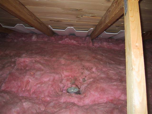

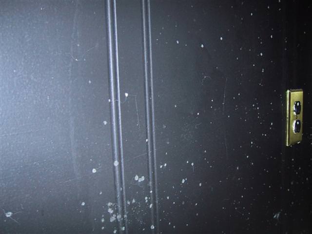

holmer Posted December 6, 2005 Report Share Posted December 6, 2005 Hi All, Situation: Bathroom vent terminates in a poorly ventilated attic in a small one story home. The home owners complain of heavy condensation on all windows and on the chimney that is exposed all the way down. One bedroom has persistent mildew spots on the interior walls. None of these spots appear anywhere else in the home. I am certain that the condensation is a result of high relative humidity indoors. Question: Why does the mildew just appear in this one room? It is the only room painted ALL black, could it be something in the paint? Download Attachment: attic.jpg 45.26 KB Download Attachment: spots.jpg 35.32 KB Thanks, Quote Link to comment Share on other sites More sharing options...
hausdok Posted December 6, 2005 Report Share Posted December 6, 2005 Hi, Is it the room where adults sleep? Adults pump a lot of moisture into the air at night. If the rooms of that wall are poorly insulated, you'd be getting condensation on them wherever nailheads cool the surface or there are air leaks. That condensation will feed the mildew. Get that attic vented to the exterior, get a good ground cover on the soil beneath the home if there is a crawlspace and ventilate the home better. ONE TEAM - ONE FIGHT!!! Mike Quote Link to comment Share on other sites More sharing options...
holmer Posted December 7, 2005 Author Report Share Posted December 7, 2005 Thanks for your input Mike Only the daughter sleeps in that room, but they did mention that the door is nearly always closed. The mildew spots are random, i.e. not on nail heads. The parents' room is right next to that room and the walls show no growth (high moisture with heavy condensation on the windows though). There were dozens of candles in the daughter's room and she seemed like the type to sit in there and burn them in her black room with gothic jewelry hanging all over the place. She did complain of headaches once the *mold* appeared (of course) but maybe she is just asphyxiating herself. I did explain to them the importance of getting the bathroom fan vented outdoors and improving the attic ventilation. I did not mention any of my thoughts about the young lady though! Thanks again, Quote Link to comment Share on other sites More sharing options...
