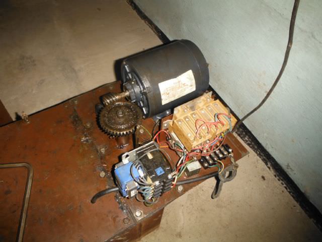

Mike Lamb Posted September 9, 2015 Report Share Posted September 9, 2015 This 1952 house had an odd machine anchored to the basement floor. I thought I took a wide shot but I guess I didn't. I tried to remove the cover but couldn't. I want to think it had something to do with drainage, either plumbing or ground water. There were no above floor pipes. The house had all gravity sewer. There was a newer French drain installed at the basement foundation perimeter. Click to Enlarge 48.22 KBt Quote Link to comment Share on other sites More sharing options...
Jerry Simon Posted September 9, 2015 Report Share Posted September 9, 2015 This 1952 house had an odd machine anchored to the basement floor. I thought I took a wide shot but I guess I didn't. I tried to remove the cover but couldn't. I want to think it had something to do with drainage, either plumbing or ground water. There were no above floor pipes. The house had all gravity sewer. There was a newer French drain installed at the basement foundation perimeter. Click to Enlarge 48.22 KBt Gate valve motorized shut-off for sewer main to prevent sewage back-up in heavy rainfall is my best guess (for all you non-Chicago area guys, Chicago and many surrounding suburbs have one sewer system that handles both sanitary water and rain water; this is directly related to why the flow of the Chicago River was reversed back about 1900). Quote Link to comment Share on other sites More sharing options...
Mike Lamb Posted September 9, 2015 Author Report Share Posted September 9, 2015 Sounds good. I have never seen motorized before; just the manual steering wheel shut-off valve. Quote Link to comment Share on other sites More sharing options...
plummen Posted October 9, 2015 Report Share Posted October 9, 2015 Fancy motorized back water valve? Quote Link to comment Share on other sites More sharing options...
