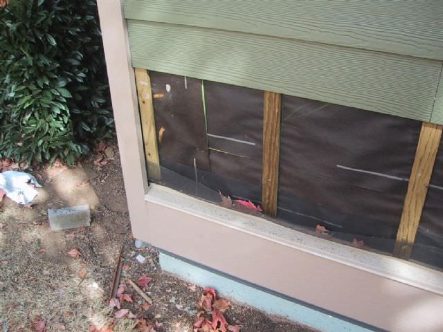

Leighton Jantz Posted September 19, 2015 Report Share Posted September 19, 2015 Anyone seen flashings like this? House built in '13 they are over all windows, doorways etc. Click to Enlarge 33.6 KB Quote Link to comment Share on other sites More sharing options...
Leighton Jantz Posted September 19, 2015 Author Report Share Posted September 19, 2015 Overkill or good practice? Quote Link to comment Share on other sites More sharing options...
BADAIR Posted September 19, 2015 Report Share Posted September 19, 2015 Anyone seen flashings like this? House built in '13 they are over all windows, doorways etc. Click to Enlarge 33.6 KB appear to be field fabricated sill pan flashing @ head and sill https://www.google.com/search?q=sill+pa ... 00&bih=779 i'd have to see a window head flashing the upper at the hose sillcock really isn't the proper method also i'd like to see tooled elastomeric sealant at the dissimilar material joints even when the purported wrb is present Quote Link to comment Share on other sites More sharing options...
Marc Posted September 19, 2015 Report Share Posted September 19, 2015 Overkill or good practice? Looks like he didn't have the correct flashing part in his truck so he made up something. It's not what the vinyl manufacturer had in mind and I can't tell for sure from the photo whether it will leak or not. I'd write it to explain it but would not make any recommendation, just FYIO (for your information only). Marc Quote Link to comment Share on other sites More sharing options...
kurt Posted September 19, 2015 Report Share Posted September 19, 2015 It looks like the guy understood exactly what he was trying to do. Head cap w/back and end dams, kickout at the bottom. J channel prevents the channel extending past the opening, but that's about it. If it was caulked at the upper edge of the head cap, it'd actually be pretty good. The Vinyl Siding Institute has a couple details in their manual that are sort of kind of like this. Ideally, the flashing would extend past the J channel, but that's not possible. I'd guess that the job was well done based on the detail around the hose bibb. Quote Link to comment Share on other sites More sharing options...

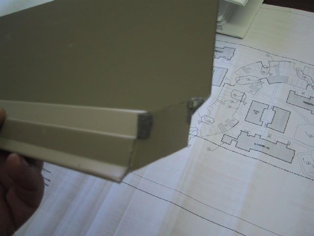

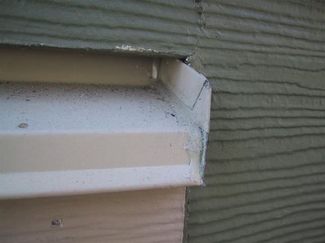

Jim Katen Posted September 19, 2015 Report Share Posted September 19, 2015 Originally posted by kurt . . . I'd guess that the job was well done based on the detail around the hose bibb. Agreed. I'm not sure what the other guys are seeing as a problem here, unless they're unaware of flashings with end dams. These have been common in better siding installations in my area for the past 15 years or so. There's even a variant in which the end dam goes up and also goes down again, so there's no need to overhang the trim. Pics attached. Click to Enlarge 26.9 KB Click to Enlarge 27.74 KB Click to Enlarge 60.79 KB Click to Enlarge 44.79 KB Click to Enlarge 34 KB Quote Link to comment Share on other sites More sharing options...
