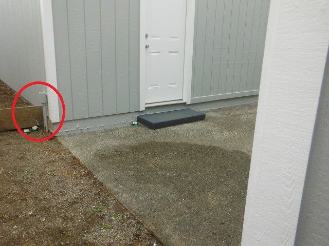

Denray Posted September 22, 2015 Report Share Posted September 22, 2015 The garage has 4 cables going into it coming from the main panel on the house. Being a separate building shouldn't it have a sub panel and ground rod? Click to Enlarge 62.01 KB Click to Enlarge 51.72 KB Quote Link to comment Share on other sites More sharing options...
Marc Posted September 22, 2015 Report Share Posted September 22, 2015 Yes. As guru Katen would say, 'the requirements for the main panel in the house are again required for the panel in a detached structure', or something like that. That assumes there are no ground conductors or conductive conduits between house and detached structure. Marc Quote Link to comment Share on other sites More sharing options...
Denray Posted September 22, 2015 Author Report Share Posted September 22, 2015 Because it is a separate building with more than one circuit it should have a ground rod, right? And the only way to tie one in would be to have a sub panel, right? It would have to be a 4 wire feeder because of the concrete patio that touches both foundations, right? Quote Link to comment Share on other sites More sharing options...
Marc Posted September 22, 2015 Report Share Posted September 22, 2015 Because it is a separate building with more than one circuit it should have a ground rod, right? Except for some special circumstances, not more than one circuit or one feeder should supply the entire needs of a detached building. The ground rod requirements kicks in on all detached structures that have a panel. And the only way to tie one in would be to have a sub panel, right? It would seem so. It would have to be a 4 wire feeder because of the concrete patio that touches both foundations, right? Three wire for 120/240 service. Don't need the ground wire. If there's a continuous metallic path between house and separate building (such as a ground wire or metallic conduit) then don't join the neutral bar to the ground bar in the panel of the separate building because that might result in neutral currents in the metallic path. Ground rod connects only to ground bus. If there's no continuous metallic path between house and separate building, join the neutral bar to ground bar, just like you would on the main panel in the house. Look at the drawing in 250.32 (A) and focus on the sentence at the bottom of that drawing that says 'No continuous metallic paths between Building 1 and Building 2'. Clue: there's a continuous metal path between Building 2 and Building 3. Concrete isn't a continuous metallic path but that ground wire is. Marc Quote Link to comment Share on other sites More sharing options...
Denray Posted September 22, 2015 Author Report Share Posted September 22, 2015 Thank you, thank you very much! Quote Link to comment Share on other sites More sharing options...
