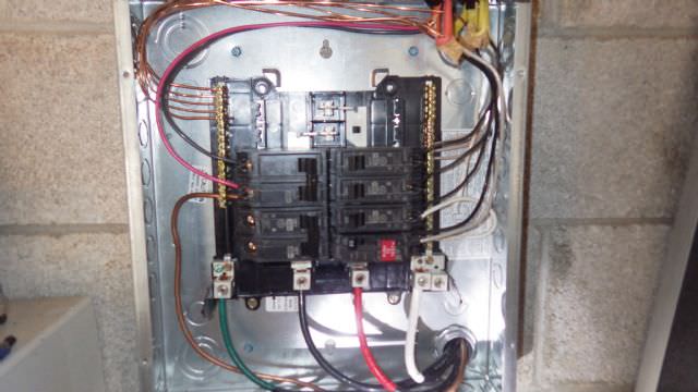

Erby Posted September 29, 2015 Report Share Posted September 29, 2015 Ran into this today. Detached garage with a 30 amp feed from the house panel. Four wire and a grounding electrode with neutrals and grounds separated with the ground bar bonded to the panel. Is it right? Click to Enlarge 45.93 KB Quote Link to comment Share on other sites More sharing options...
Marc Posted September 29, 2015 Report Share Posted September 29, 2015 Yes. A good way to check if it's right is to ask yourself two questions: is there an alternate path for neutral currents (there shouldn't be any); can a ground fault in the garage find it's way to the neutral in the main panel (it should). Neither your ground bus nor the panel enclosure in the garage is connected to the neutral bus in the garage so there's no alternate path for the garage neutral currents. That answers question #1. As for question #2, you have four wire service to the garage so the ground bus in the garage is connected through the ground wire in the feeder to the neutral in the main panel making that an affirmative for question #2. You're good to go. Marc Quote Link to comment Share on other sites More sharing options...

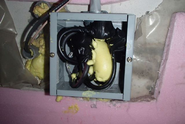

mjr6550 Posted October 8, 2015 Report Share Posted October 8, 2015 I'm saving this post. Mr. Katen's reply with the #1, 2, and 3 does a good job explaining this. This has always confused me because I can't recall seeing a detached garage with a separate ground rod in the past 30 years (I probably have seen a few, but they are rare). Today I did see one in a 2003 garage. Four wires leaving the main panel, three showing up at the garage panel. Neutrals and grounds on same terminal. Assuming the conduit is plastic and the ground wire does not continue to the garage panel, it appears that this is ok? Click to Enlarge 45.52 KB Click to Enlarge 42.67 KB Click to Enlarge 40.93 KB Quote Link to comment Share on other sites More sharing options...

Jim Katen Posted October 9, 2015 Report Share Posted October 9, 2015 . . . Today I did see one in a 2003 garage. Four wires leaving the main panel, three showing up at the garage panel. Neutrals and grounds on same terminal. Assuming the conduit is plastic and the ground wire does not continue to the garage panel, it appears that this is ok? If the junction box (the one with the foam in it) is in the garage, I'd call it wrong and tell them that they have a four-wire feeder and they have to separate the grounds & neutrals. If the junction box is in the house, then I'd say that the installation is ok, per the pre-2008 NEC. (But still dumb.) The foam is wrong no matter what. Quote Link to comment Share on other sites More sharing options...
mjr6550 Posted October 10, 2015 Report Share Posted October 10, 2015 The,junction box was in the house, so I assumed it was ok. Because of the foam I could not see where the ground wire terminated. Quote Link to comment Share on other sites More sharing options...
