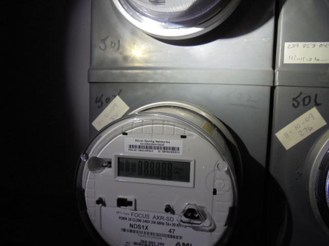

Mike Lamb Posted October 15, 2015 Report Share Posted October 15, 2015 This condo has smart meters. The main disconnect for each service is usually right next to the meter. I don't see any. There was no main disconnect at the subpanel inside the condo unit. How does the occupant shut down the main? Click to Enlarge 30.3 KB Click to Enlarge 32.8 KB Quote Link to comment Share on other sites More sharing options...
plummen Posted October 15, 2015 Report Share Posted October 15, 2015 Thats a good question,Can you follow the service coming out of each meter to see if theres disconnects someplace in the basement?[:-bigeyes Quote Link to comment Share on other sites More sharing options...
Mike Lamb Posted October 16, 2015 Author Report Share Posted October 16, 2015 Nope. Limited access to the bldg. Quote Link to comment Share on other sites More sharing options...
kurt Posted October 16, 2015 Report Share Posted October 16, 2015 I see those where there is an array of main disconnects in a central closet. That's probably it. Quote Link to comment Share on other sites More sharing options...
Scottpat Posted October 16, 2015 Report Share Posted October 16, 2015 I had an office condo a few weeks ago. All units had smart meters on a wall and then all of the main disconnect breakers were in a mechanical room closet?. Quote Link to comment Share on other sites More sharing options...

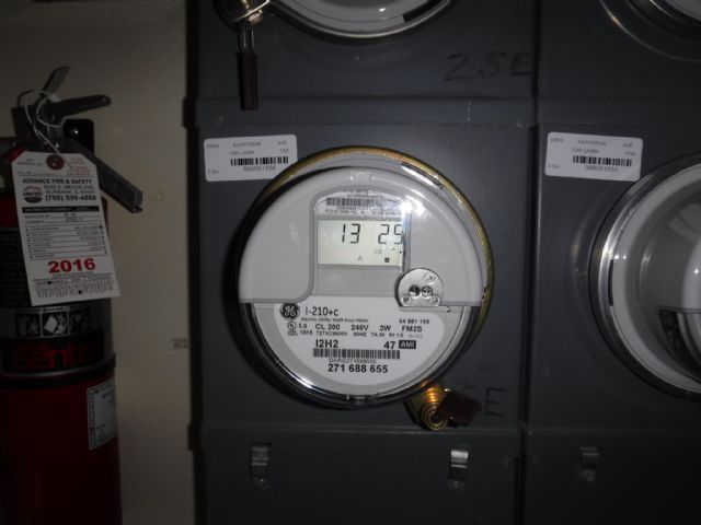

Mike Lamb Posted August 24, 2016 Author Report Share Posted August 24, 2016 Another condo with smart meters and no main disconnect anywhere. There was a main disconnect to shut down the power for the entire building. I doubt that counts. Nobody else is seeing this during their inspections? Click to Enlarge 31.2 KB Quote Link to comment Share on other sites More sharing options...
kurt Posted August 24, 2016 Report Share Posted August 24, 2016 See it all the time. In fact, my apartment building is like that; 7 panels, no disconnects, just a main building disconnect. There's thousands of them like this in Chicago. Any work happens in the building, the City makes them upgrade. Nothing happening, they cruise along like this. Quote Link to comment Share on other sites More sharing options...
