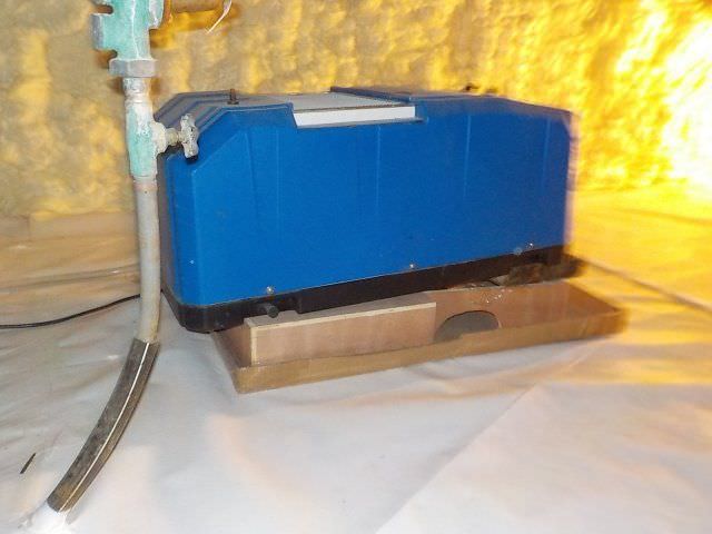

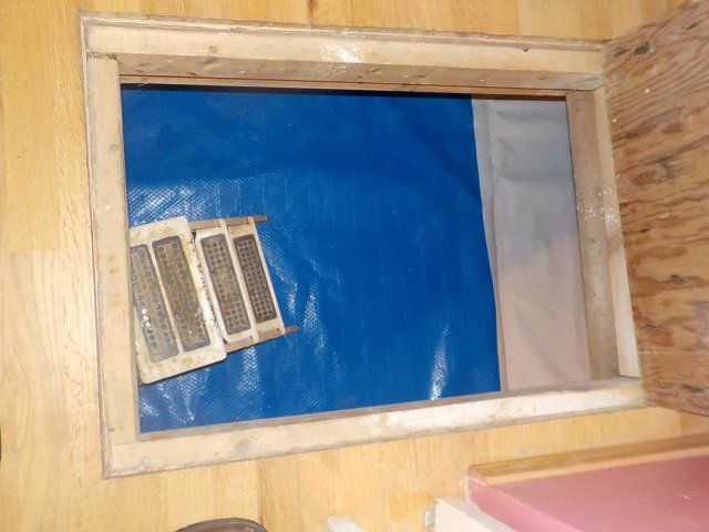

I was told the owners spent over $20G repairing this 15 year old wet crawlspace. It looked pretty good, new sump pit, big dehumidifier, and an exhaust fan on a humidistat. Lots of sealed poly and spray foam.

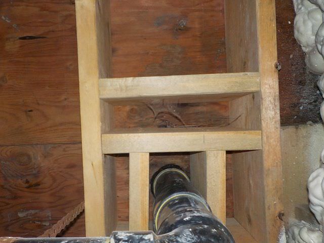

Some joists were sistered. I saw some new blocking under a toilet and a dark area at the exterior wall.

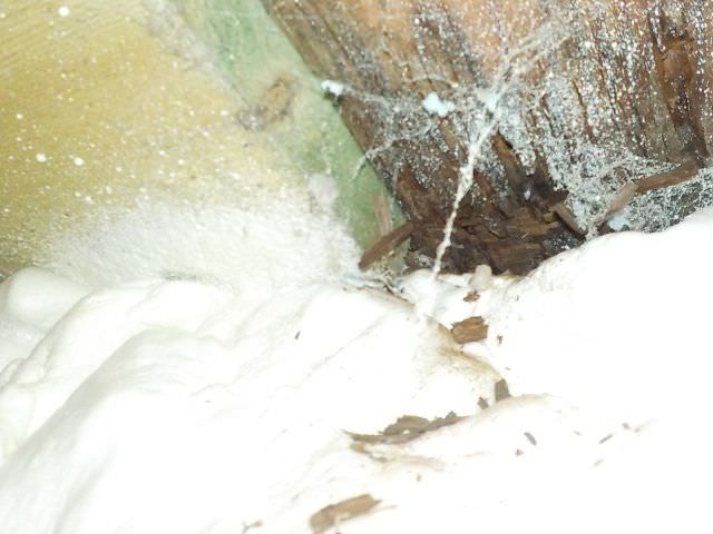

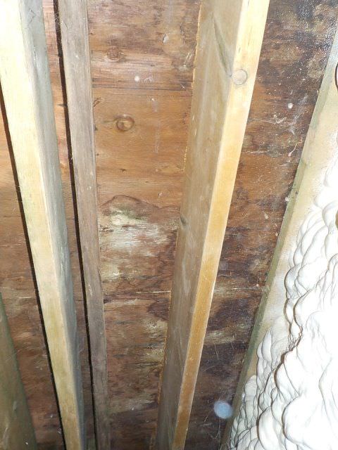

Sorry, but the subfloor is kind of rotten in several places. [:(]

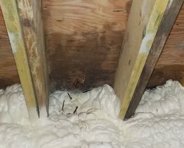

66.2 KB
No telling what damage is hidden behind the foam insulation.
