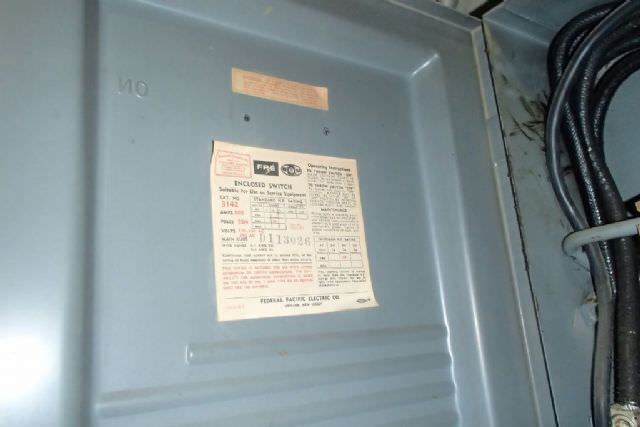

mjr6550 Posted October 26, 2015 Report Share Posted October 26, 2015 I inspected a warehouse/office building today that was built in 1963. At the time the building was apparently supplied with 2 phase power. Two transformers were later added, apparently to convert the 2 phase to three phase. I think that I understand what I am looking at, but thought that the photos may be of interest (and maybe teach me something). With 2 phase you have two hots and two neutrals and end up with three hots and a neutral? How does the transformer create the third phase? Click to Enlarge 37.66 KB Click to Enlarge 42.01 KB Click to Enlarge 29.12 KB Click to Enlarge 49.7 KB Click to Enlarge 50.19 KB Click to Enlarge 36.51 KB Quote Link to comment Share on other sites More sharing options...

Marc Posted October 26, 2015 Report Share Posted October 26, 2015 Two phase power never made it past the runoff when AC power first advanced past the single phase configuration. Other configurations, like 5 phase, never even made it past the drawing board. They all quickly yielded to the 3 phase configuration which was shown to transmit more power per given amount of conductor material than anything else. There were other reasons for the superiority of 3 phase, such as simpler electric motor design. In 63', I doubt any 2 phase systems remained for the simple reason that you can't obtain decent 2 phase (0 degree and 90 degree vectors) service from either single or three phase (0 degree, 120 degree and 240 degree vectors) sources without a motor-generator. Likely what you saw was the voltage transformation of a three phase system by using an 'open-delta' connection. The 'open-delta' connection requires only two single phase transformers (the common terminal is the third leg). It's an inefficient and wasteful use of transformer capacity but it saves you the trouble of needing three of them. It's very common among utilities who need to get three phase power to small-fry locations like Kurt's wood shop. I remember reading of 'converters' that would yield 3 phase from a single phase source but they're only crude approximations of true 3 phase power. Marc Quote Link to comment Share on other sites More sharing options...

mjr6550 Posted October 27, 2015 Author Report Share Posted October 27, 2015 Sorry, posted the wrong photos. Philadelphia is one of the strange places that did use 2 phase power. I know people that use rotary phase converters to run 3 phase machine shop equipment in their houses. I also saw one recently in a house where the owner had a 22" planer. They look more like a motor than a transformer. Quote Link to comment Share on other sites More sharing options...

mjr6550 Posted October 29, 2015 Author Report Share Posted October 29, 2015 From what I understand I don't believe that two-phase is supplied anymore. I believe it is now a three-phase system. One of the transformers fed a three-phase trash compactor, but the fuses upstream of the three-phase circuit breaker had been removed so it appeared that it was no longer used. I did not locate anything else operating on three phase. Everything was from 1963, including a couple Federal Pacific circuit breaker panels. It needs major work. Quote Link to comment Share on other sites More sharing options...
