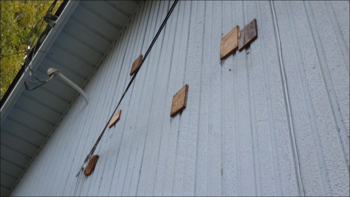

Denray Posted November 4, 2015 Report Share Posted November 4, 2015 What the heck is it? Click to Enlarge 89.58 KB Click to Enlarge 56.85 KB Quote Link to comment Share on other sites More sharing options...
Jim Baird Posted November 4, 2015 Report Share Posted November 4, 2015 "Larry the Cable Guy" was here. Quote Link to comment Share on other sites More sharing options...
Denray Posted November 4, 2015 Author Report Share Posted November 4, 2015 What do you suppose makes the texture? Seems like a somewhat recent application. Good luck matching that if you ever have to fix it. Quote Link to comment Share on other sites More sharing options...
BADAIR Posted November 5, 2015 Report Share Posted November 5, 2015 appears to be coarse aggregate, cement-based, stucco finish many products in the market paint applied after finish cures here's 1 mfr http://omega.omega-products.com/p--102- ... o--46.aspx Quote Link to comment Share on other sites More sharing options...
Denray Posted November 5, 2015 Author Report Share Posted November 5, 2015 Doesn't sound like it should be put over Redwood? ColorTek Paint Grade Exterior Stucco may applied over the following products: 1. One coat stucco 2. Brown coat 3. Stucco 4. CMU/poured-in-place and/or tilt-up concrete/masonry 5. Approved Omega base coats and/or cementitious finishes Quote Link to comment Share on other sites More sharing options...
hausdok Posted November 5, 2015 Report Share Posted November 5, 2015 Fake stucco paint. The house I did today was covered with that crap. I was once told they freeze old tires using liquid oxygen or nitrogen or something like that and then pulverize the frozen tires to get the texture material for that stuff. It's then mixed with the equivalent of garage floor/porch paint and applied over the wood siding. It tends to peel off in large patches whenever the wood beneath it gets damp. Have no idea whether the frozen tire story is true. Back in 2001 during the one year non-compete I did rescuing bungalows in Seattle we stripped all of the T1-11 siding off a really ugly electric blue 1923 Bungalow that some Numbnuts had stripped the original claps off of, installed the T1-11 and then coated the T1-11 with that crap. Jacked the porch overhang up about 4-inches to get it level again, installed some full-span LVL beams under the second level to keep things straight and then replaced the posts at the front corners. Resurfaced the porch in period authentic douglas-fir T & G and re-clad the whole thing in Hardiplank and replicated all of the trim details found in an old 1933 tax assessor photograph. Went from the ugliest house within half a mile to the best looking house on the block. ONE TEAM - ONE FIGHT!!! Mike Quote Link to comment Share on other sites More sharing options...

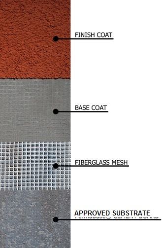

BADAIR Posted November 5, 2015 Report Share Posted November 5, 2015 Doesn't sound like it should be put over Redwood? ColorTek Paint Grade Exterior Stucco may applied over the following products: 1. One coat stucco 2. Brown coat 3. Stucco 4. CMU/poured-in-place and/or tilt-up concrete/masonry 5. Approved Omega base coats and/or cementitious finishes i was in no way endorsing the application as seen aren't the $hould$ what pay the bills ;~)) somewhere in my files i have pix of $1M+ shaq where originally designed & built with the crap shot directly over osb substrate prior inspector misidentify as DEFS...whoop$$$$,$$$.00 DEFS requires approved substrate, mesh, base & finish Click to Enlarge 29.53 KB Quote Link to comment Share on other sites More sharing options...
Denray Posted November 5, 2015 Author Report Share Posted November 5, 2015 Thanks for the info everyone! Just didn't seem right to be over wood. Quote Link to comment Share on other sites More sharing options...
