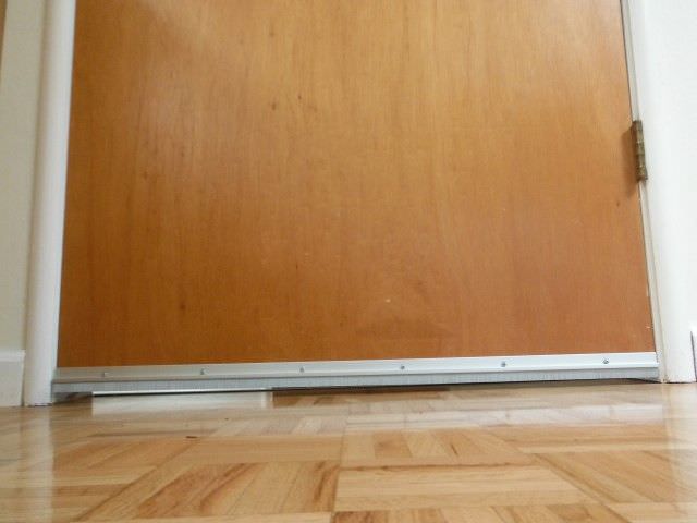

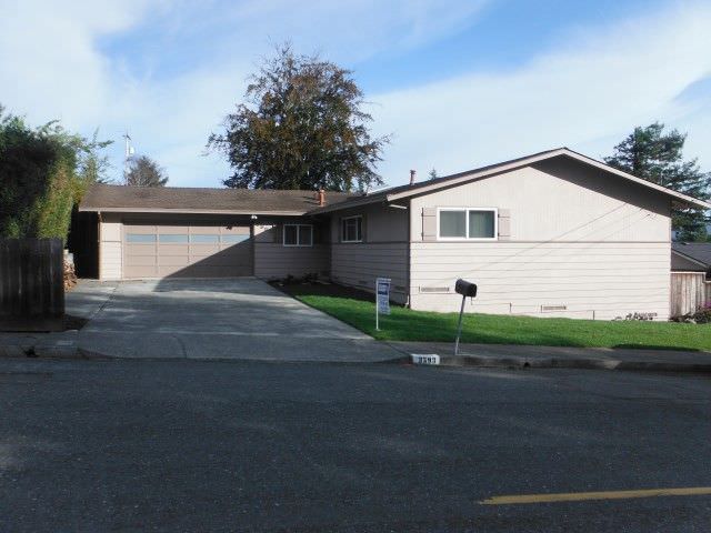

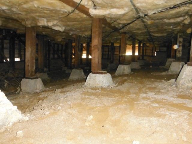

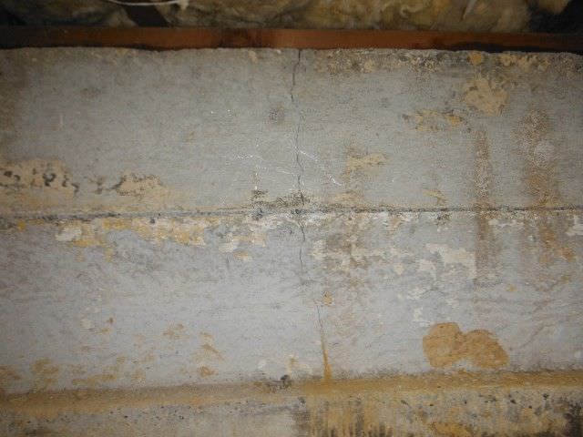

Denray Posted November 4, 2015 Report Share Posted November 4, 2015 1964 built. There's about 8 cracks around the perimeter foundation. Some are only 5 feet apart. Most are a little wider at the top. No footers for the piers. You can see the dip in the siding and it correlates with the dip in the kitchen floor. Is this par for a house this old or time for a geotech? Click to Enlarge 50.91 KB Click to Enlarge 51.94 KB Click to Enlarge 49.93 KB Click to Enlarge 33.77 KB Click to Enlarge 55.78 KB Quote Link to comment Share on other sites More sharing options...
mjr6550 Posted November 4, 2015 Report Share Posted November 4, 2015 The crack in the foundation wall looks like a typical shrinkage crack. I cannot tell much from the other photos. What I am seeing does not concern me, but the pictures may not be showing everything you saw. Quote Link to comment Share on other sites More sharing options...

Marc Posted November 4, 2015 Report Share Posted November 4, 2015 That much settling is not so unusual here after 50 yrs of service. I've never seen a house with piers so closely spaced. Time for a re-level with shims on the piers and poured pilings beneath the grade beams (linear foundation). Disregard the lack of footing. It's been 50 yrs. Marc Quote Link to comment Share on other sites More sharing options...
Jim Baird Posted November 4, 2015 Report Share Posted November 4, 2015 ...first pic looks like a poured wall. I see some swag in the siding. Is this a modular maybe? Quote Link to comment Share on other sites More sharing options...
Denray Posted November 4, 2015 Author Report Share Posted November 4, 2015 It's a 64 built redwood. Very back room was added on. Quote Link to comment Share on other sites More sharing options...

John Kogel Posted November 5, 2015 Report Share Posted November 5, 2015 I suggest they could pull the downspouts out of the perimeter drain system. I assume there is just the one drain around the exterior foundations. The downspouts should flow into their own drain pipe. Even so, the crack in the pic is a non-issue. There is certainly no shortage of support for that floor. With that many piers, footings under the piers are maybe not that necessary. As suggested, a few piers may have settled to cause that dip in the interior portion of the floor. If the roof line is fairly straight, I would not place too much emphasis on dips in the siding. Quote Link to comment Share on other sites More sharing options...
