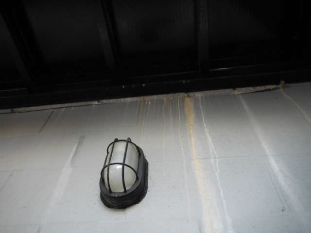

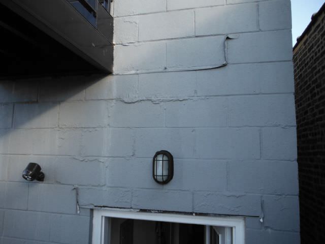

Mike Lamb Posted November 6, 2015 Report Share Posted November 6, 2015 Is flashing required at floor lines with CMU? I can not find any tech notes for this. Click to Enlarge 52.55 KB Click to Enlarge 61.69 KB Quote Link to comment Share on other sites More sharing options...

Mike Lamb Posted November 9, 2015 Author Report Share Posted November 9, 2015 This was a 2 yr old flat face single wythe CMU. Flashings were visible where I expected them and this is a rare time I have seen visible end dams and expansion joints, although some of the end dams were confusing. See photos. The building was leaking inside but all the leaks I believe were from water penetration at the back deck ledger bolts, and water running down the walls from poorly installed parapet coping. And there were a bunch of roof leaks beneath a whole roof deck sitting directly on the roof. Click to Enlarge 33.01 KB Click to Enlarge 21.62 KB Click to Enlarge 29.03 KB Click to Enlarge 23.55 KB Quote Link to comment Share on other sites More sharing options...
kurt Posted November 9, 2015 Report Share Posted November 9, 2015 Those ledger bolts are a hole straight through the wall. There should be a horse collar or some kind of flashing to seal the bolt hole, but there never is. Any time you see those steel ledgers and bolts, expect leaks. Coping is always screwed up and leaking. The roof deck leaks aren't hard to figure out. Take up the deck and you'll find them. Quote Link to comment Share on other sites More sharing options...
