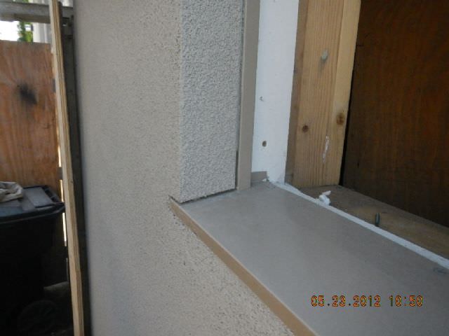

kurt Posted November 24, 2015 Report Share Posted November 24, 2015 Here's a pic of how we set windows in stucco.....it's a sheet metal sill pan and jamb fabrication, and the window sans any molding or nailing flange is slid in from the interior. The 2nd pic shows the window in place, with a small wick that drains the pan. Click to Enlarge 37.12 KB Click to Enlarge 65 KB Quote Link to comment Share on other sites More sharing options...
Scottpat Posted November 24, 2015 Author Report Share Posted November 24, 2015 Here's a pic of how we set windows in stucco.....it's a sheet metal sill pan and jamb fabrication, and the window sans any molding or nailing flange is slid in from the interior. The 2nd pic shows the window in place, with a small wick that drains the pan. Click to Enlarge 37.12 KB Click to Enlarge 65 KB That's sexy! I have seen similar details before like that and its about the only way to install a window in my opinion?. Quote Link to comment Share on other sites More sharing options...
kurt Posted November 24, 2015 Report Share Posted November 24, 2015 Yes. God Bless CNC sheet metal fabricators. The longer I do this thing, the more I think in terms of sheet metal solutions. Quote Link to comment Share on other sites More sharing options...
