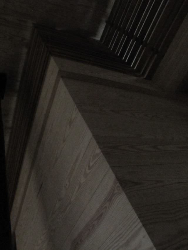

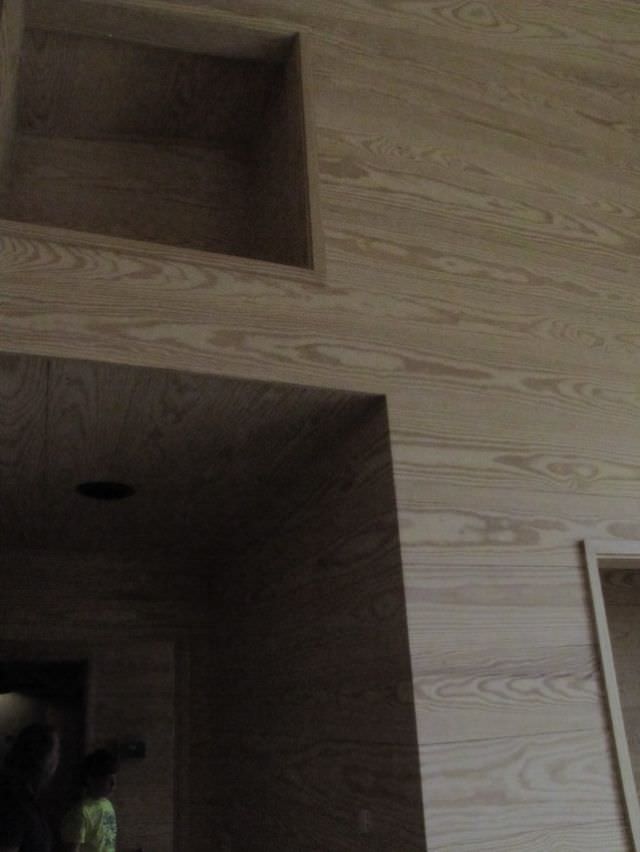

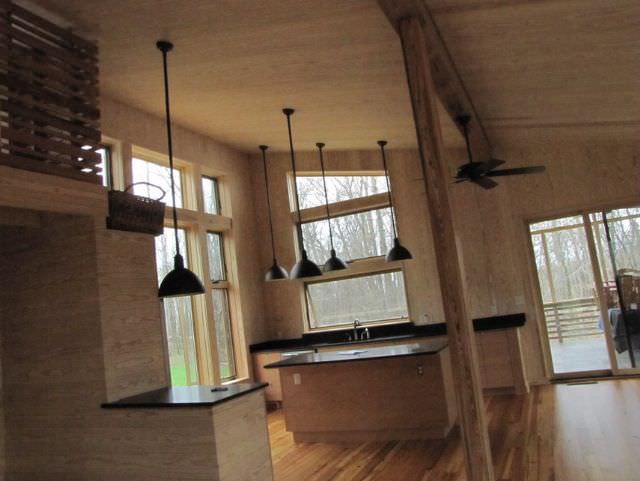

Jim Baird Posted March 11, 2016 Report Share Posted March 11, 2016 My friend's client wanted Southern Yellow Pine paneling, horizontal, no corner trim, and that is what he got...a kind of down-home minimalism. Comments? Click to Enlarge 50.23 KB Click to Enlarge 53.12 KB Click to Enlarge 46.09 KB Click to Enlarge 56.14 KB Click to Enlarge 56.05 KB Click to Enlarge 77.45 KB Quote Link to comment Share on other sites More sharing options...
kurt Posted March 11, 2016 Report Share Posted March 11, 2016 Sure. It looks ok. I think it would look better with a thoughtful trim detail though. How's it installed? Any breather pad under the siding? Quote Link to comment Share on other sites More sharing options...

AHI in AR Posted March 12, 2016 Report Share Posted March 12, 2016 From what I can see, the interior details look nice. Personally, I like a simple, minimalist look if the other architectural details support it. But as Jim hinted, SYP doesn't play well with temperature and (especially) moisture exposure/changes. I suspect that the siding will be doing the "twist and shout" and working it's way off the home shortly. 30-80 year old cedar or cypress looks better around here in a similar climate than 5 year old pine--even if was carefully back primed and painted. Quote Link to comment Share on other sites More sharing options...
John Kogel Posted March 12, 2016 Report Share Posted March 12, 2016 I don't like the corners without trim. Wood doesn't take 90 degree turns in the real world, so why force it? It just doesn't look right to me. Quote Link to comment Share on other sites More sharing options...

gtblum Posted March 12, 2016 Report Share Posted March 12, 2016 I don't like the corners without trim. Wood doesn't take 90 degree turns in the real world, so why force it? It just doesn't look right to me. I like it because because of that. They did a nice job matching the grain on the corners. I also like the flat sawn panels better than if they were rotary cut. Don't see much of that with pine. Quote Link to comment Share on other sites More sharing options...
