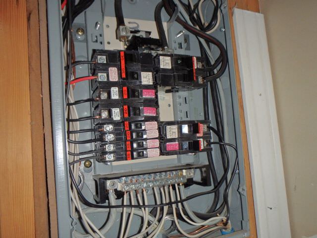

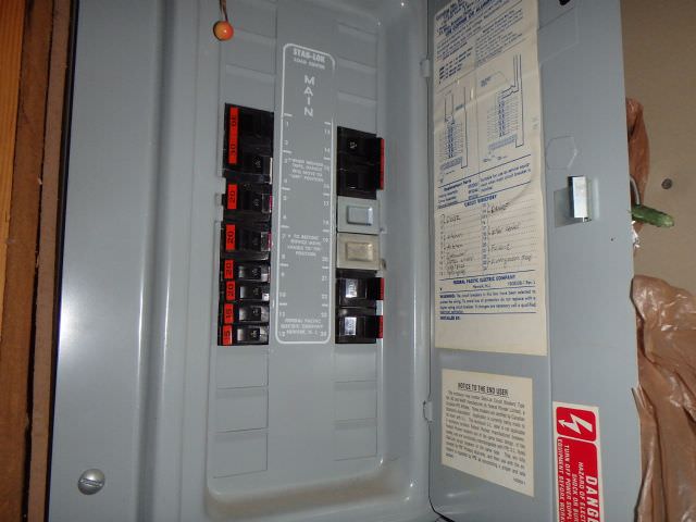

Inspector1 Posted March 30, 2016 Report Share Posted March 30, 2016 I was inspecting a condo unit. I came across a Federal Pacific Electric with "Stab-Lok" circuit breakers. The panel was clean as a whistle. The condo was 34 years old. Are all Federal Pacific Electric recalled. I'm sure this unit has been inspected before. Would the condo association ever have all the panels changed out? I recommended that it be evaluated by a electrician. Click to Enlarge 41.25 KB Click to Enlarge 58.99 KB Click to Enlarge 61.42 KB Quote Link to comment Share on other sites More sharing options...
kurt Posted March 30, 2016 Report Share Posted March 30, 2016 There's never been a recall that I'm aware of. The company was charged with falsifying test data on their breakers. The company (sort of) vanished into a blizzard of corporate proxies and owners, so there wasn't a company to charge with an official recall. I think that's about right.....there may be more details I'm not aware of. Quote Link to comment Share on other sites More sharing options...
Inspector1 Posted March 30, 2016 Author Report Share Posted March 30, 2016 Maybe not recalled but other evidence of "safety issues", The electricians that I have spoke to almost always change them out. Quote Link to comment Share on other sites More sharing options...
Jim Katen Posted March 30, 2016 Report Share Posted March 30, 2016 . . I recommended that it be evaluated by a electrician. . . . I suggest that you learn enough about these panels so that you can confidently recommend that people have them replaced instead of recommending evaluation by others. Quote Link to comment Share on other sites More sharing options...

Nolan Kienitz Posted March 30, 2016 Report Share Posted March 30, 2016 Maybe not recalled but other evidence of "safety issues", The electricians that I have spoke to almost always change them out. Does that information from electricians you have spoken with not speak volumes to you? Use a version of that in your report comments and tell your client your opinion ... don't keep kicking it down the road. Quote Link to comment Share on other sites More sharing options...
Robert Jones Posted March 30, 2016 Report Share Posted March 30, 2016 While you are educating yourself about the issues with FPE panel's, learn about Zinsco/Sylvania panel's as well. Both should always be recommended for replacement. Quote Link to comment Share on other sites More sharing options...
