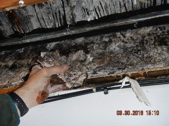

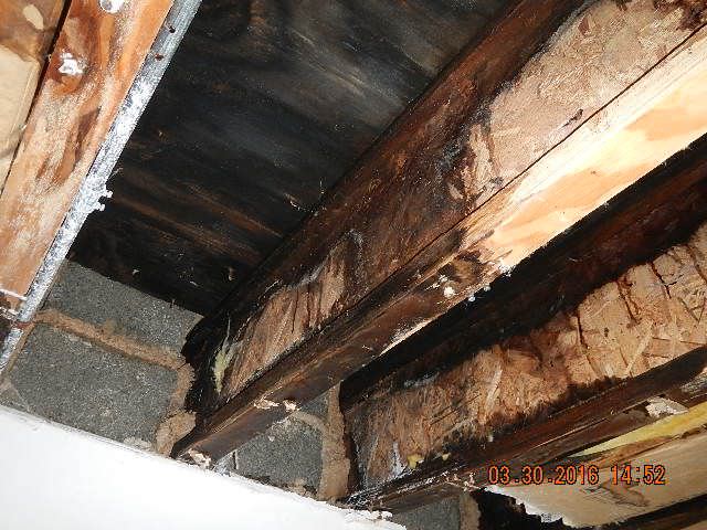

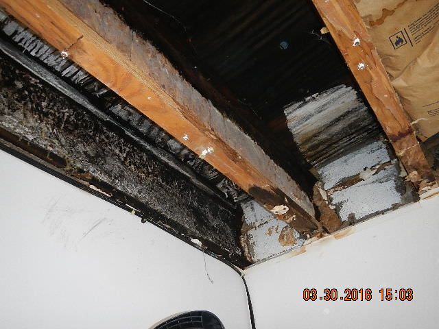

kurt Posted March 30, 2016 Report Share Posted March 30, 2016 A big, expensive deck. On a big expensive house about 10 years old. It'll take a couple weeks to get to the point where we're staring up at the sky, another week to frame in new structure, and several weeks to button it all up and rebuild a new deck. Or something like that. All because someone thought one didn't need flashing under stone coping. Stone is waterproof, right? No water migrates through limestone, right? Click to Enlarge 81.81 KB Click to Enlarge 63.02 KB Click to Enlarge 81.81 KB Click to Enlarge 64.19 KB Click to Enlarge 84.18 KB Quote Link to comment Share on other sites More sharing options...

John Dirks Jr Posted March 31, 2016 Report Share Posted March 31, 2016 Is the whitish color frost or fungus? Quote Link to comment Share on other sites More sharing options...
kurt Posted March 31, 2016 Author Report Share Posted March 31, 2016 That's full tilt white rot. The webs on the TJI's are literally compost mush. The whole thing is settling about 5" on a 20' span. This one could have collapsed into the FR; it's not just a balcony; it's about 500sf of nastiness. Solid load bearing masonry exterior walls. No capillary breaks/boots on the joist ends. No squash blocks. No flashing under the coping. No nothing. Mold food joists set in wet CMU's. Woof.... I have a few photos of the topside, but the owner is understandably traumatized and adamant that no identifiable photos be distributed. I'm only allowed to show the rotten areas and the subsequent repairs for "public education". No identifiable anything. Just the mess. I think he's being reasonable. Most folks wouldn't even let me do this. Quote Link to comment Share on other sites More sharing options...
Tom Raymond Posted March 31, 2016 Report Share Posted March 31, 2016 Ouch. Is this just bad flashing or one of those silly split face block fiascos? The only good part is those 20 foot I joists can be shoveled into contractor bags. I can't imagine staging that many building materials in your urban environment. Quote Link to comment Share on other sites More sharing options...
kurt Posted March 31, 2016 Author Report Share Posted March 31, 2016 Cavity wall. Not bad flashing....no flashing, cavity full of slump mortar. Staging is a logistical ballet, this is in the heart of rich urban professional territory. Neighbors, literally about 3' away, have to also be mollified. Appearances must be maintained. Interestingly, when the drywall came off, we found someone had painted the inside block face with waterproofing paint. Quote Link to comment Share on other sites More sharing options...

kurt Posted March 31, 2016 Author Report Share Posted March 31, 2016 That's what's interesting. It hadn't been raining in there. It had been soaking it up like a sponge for years. Nothing was visible except the sag. It's only in the last year they noticed the moldy smell. It's frightening. This stuff can be hidden for years without us knowing it. You couldn't have convinced me of this until now. Quote Link to comment Share on other sites More sharing options...

RJ Posted April 9, 2016 Report Share Posted April 9, 2016 The garbage snippet was pretty funny. I'll be the one holding the bag. We'll use trusses hanging off a ledger, vented flashing under the capstones, vent the perimeter of the roof behind the termination. All you building enthusiasts...this is a great example of the new REbuilding BOOM. . Its too bad no one wants to pay for it!! Quote Link to comment Share on other sites More sharing options...
RJ Posted April 9, 2016 Report Share Posted April 9, 2016 Kurt, by the way,that wasn't waterproof paint. About a 1/8" of hard efflorescence. Quote Link to comment Share on other sites More sharing options...
