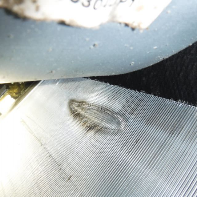

Mike Lamb Posted April 21, 2016 Report Share Posted April 21, 2016 This is the AC coil at an electric furnace. At the job, I thought it looked scorched but now I think it's just dented. Any thoughts on this damage? Click to Enlarge 75.24 KB Quote Link to comment Share on other sites More sharing options...
Marc Posted April 21, 2016 Report Share Posted April 21, 2016 I have an assortment of 'combs' that are made for straightening such aluminum fins out but that damage there is likely too far gone to fix. They break off if you try too hard to fix them. It won't have any appreciable effect on performance anyway. Ignore it. Marc Quote Link to comment Share on other sites More sharing options...
Jim Baird Posted April 22, 2016 Report Share Posted April 22, 2016 ...looks like a dropped screwdriver handle hit it. Quote Link to comment Share on other sites More sharing options...
