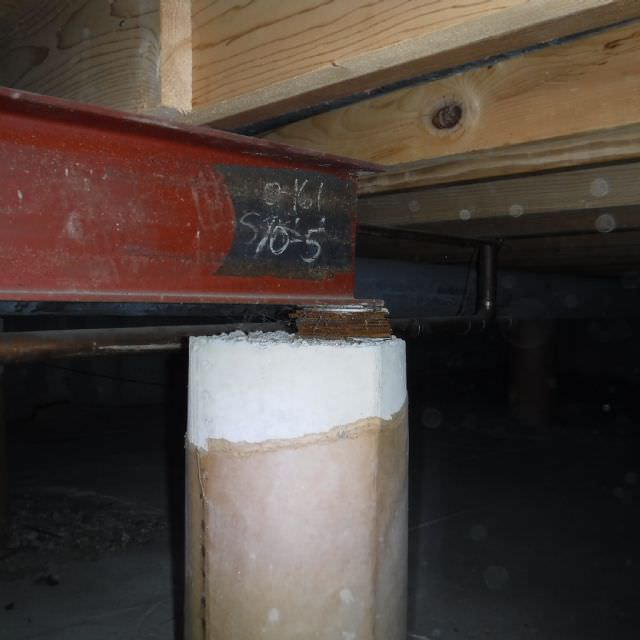

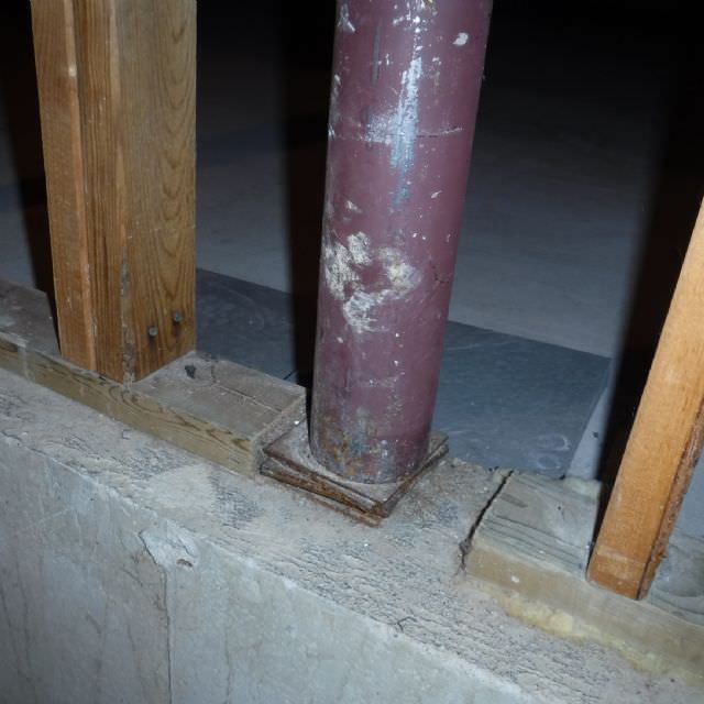

Mike Lamb Posted April 25, 2016 Report Share Posted April 25, 2016 If you had a mind to; how would you go about securing the column to foundation and beam to pier connections? Click to Enlarge 54.32 KB Click to Enlarge 41.16 KB Quote Link to comment Share on other sites More sharing options...

Tom Raymond Posted April 25, 2016 Report Share Posted April 25, 2016 Gravity works pretty well in places not prone to quakes. Accidentally shifting the column in the first pic would take far more force than most people imagine. Number 2 looks far scarier than it is. Quote Link to comment Share on other sites More sharing options...

John Kogel Posted April 25, 2016 Report Share Posted April 25, 2016 In the earthquake zone, I would improve the shim under the I-beam with a steel plate or two. In the first pic, I would build a form around the post and dump in some concrete. All this if it seemed necessary, that is. Quote Link to comment Share on other sites More sharing options...

mjr6550 Posted April 26, 2016 Report Share Posted April 26, 2016 I can think of a few ways. At the bottom, the easiest think to do would be to place blocking between the column and the adjacent studs. Then lag bolt a 2x to each side of the studs and sill. That would prevent movement in both directions (not that movement is likely to occur). For the pier, if edge distances permitted a wood block could be anchored to the top of the pier with masonry anchors and then the beam could be attached to the block with lag bolts. it would not even be necessary to drill through the flanges. Placing the bolts adjacent to the flanges with fender washers overhanging the flanges would be fine. Quote Link to comment Share on other sites More sharing options...

Marc Posted April 26, 2016 Report Share Posted April 26, 2016 We should report what we think may be a significant problem. Doesn't matter if they're gonna fix it or not. I'm not condoning inspectors who report every dang little thing. Just what you think actually needs attention and let the client be the judge on whether to take action or shelve it. I mighta said a little something about the beam's weight centered so close to the edge of the concrete pier but I'd likely ignore the pipe. Marc Quote Link to comment Share on other sites More sharing options...

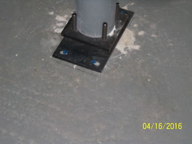

Darren Posted April 26, 2016 Report Share Posted April 26, 2016 I found these a couple of weeks ago where they replaced all the columns. Click to Enlarge 39.99 KB Click to Enlarge 28.89 KB Quote Link to comment Share on other sites More sharing options...
