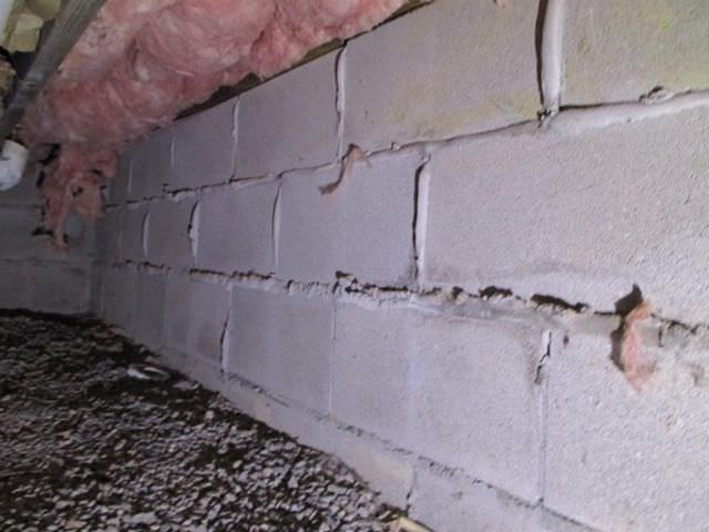

Tom Breslawski Posted April 30, 2016 Report Share Posted April 30, 2016 This is the crawlspace of a lake house, built in 2006. No cracks or movement, just sloppy mortar inside. Everything looks fine outside. I do intend to write it into the report, although it's really just cosmetic, IMO. Just wondering how some of you would write this up (or if you would). Click to Enlarge 50.12 KB Quote Link to comment Share on other sites More sharing options...
Chad Fabry Posted April 30, 2016 Report Share Posted April 30, 2016 It's not a defect. I wouldn't mention it. Quote Link to comment Share on other sites More sharing options...
ghentjr Posted April 30, 2016 Report Share Posted April 30, 2016 Nothing to tell. Quote Link to comment Share on other sites More sharing options...
Tom Breslawski Posted April 30, 2016 Author Report Share Posted April 30, 2016 No, it's not a defect. I was thinking of mentioning it so the buyer wouldn't *think* that it was a defect when they looked down there, that's all. Thanks Chad. It's not a defect. I wouldn't mention it. Quote Link to comment Share on other sites More sharing options...
Eric B Posted April 30, 2016 Report Share Posted April 30, 2016 In this case sloppy works for me. Quote Link to comment Share on other sites More sharing options...
Marc Posted May 1, 2016 Report Share Posted May 1, 2016 I wouldn't bother the client with that. Marc Quote Link to comment Share on other sites More sharing options...
Mike Lamb Posted May 1, 2016 Report Share Posted May 1, 2016 Don't mention it. Sloppy? In a crawlspace? Quote Link to comment Share on other sites More sharing options...
Scottpat Posted May 1, 2016 Report Share Posted May 1, 2016 It would not make it to my report? Not an issue.. Quote Link to comment Share on other sites More sharing options...
John Dirks Jr Posted May 1, 2016 Report Share Posted May 1, 2016 If I see anything I think might be a cause for question, even though I know it's not a problem, I'll snap a picture of it. Then, when I'm scrolling through my pictures and talking with the client I'll point it out and tell them not to worry about it. Sometimes things get a verbal mention to avoid future confusion but they do not make the report. Quote Link to comment Share on other sites More sharing options...
Tom Raymond Posted May 1, 2016 Report Share Posted May 1, 2016 I review my crawl pics with my clients on site. It may be the only time they ever see the crawlspace. I explain my concerns and anything they ask about. I could see some asking about the mortar. Quote Link to comment Share on other sites More sharing options...
kurt Posted May 1, 2016 Report Share Posted May 1, 2016 This is one of the arguments for taking pictures and archiving them for every job. I do the same; show them pics on site of the crawl because most (all) are never going in there. Of all the stuff that builds the client relationship, going in a crawl has got to be a top fiver. Quote Link to comment Share on other sites More sharing options...
John Kogel Posted May 1, 2016 Report Share Posted May 1, 2016 If I was paying a mason to lay up block at my lake house, I would probably want him to leave the mortar sloppy just like that. [] Agreed, show the clients pics of hidden areas and that would be the time to cover non-issues if they came up. Quote Link to comment Share on other sites More sharing options...

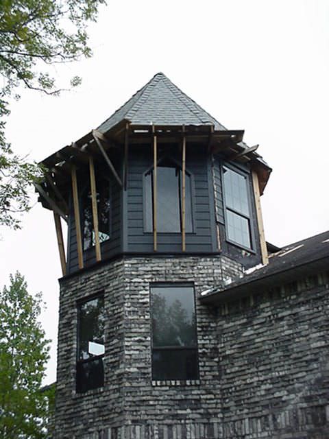

Jim Baird Posted May 1, 2016 Report Share Posted May 1, 2016 ...a brick house near here is two storey and, under direction of the eccentric owner, all the outside joints were left like that, to a surprisingly repulsive effect. Around here people call it "the castle"...don't think I have pics left, but I inspected a 3 storey tower stuck on the side that leaked for that owner. Click to Enlarge 58.29 KB Quote Link to comment Share on other sites More sharing options...
Tom Raymond Posted May 1, 2016 Report Share Posted May 1, 2016 There is a neighborhood of mid 50s ranches not far from here where that finish was popular. It's especially attractive on green brick. Quote Link to comment Share on other sites More sharing options...
Marc Posted May 1, 2016 Report Share Posted May 1, 2016 ...a brick house near here is two storey and, under direction of the eccentric owner, all the outside joints were left like that, to a surprisingly repulsive effect. Around here people call it "the castle"...don't think I have pics left, but I inspected a 3 storey tower stuck on the side that leaked for that owner. Those I write up when in combination with an absence of weeps. It's conducive to moisture infiltration issues, somewhat related to the issue with split-face block. Marc Quote Link to comment Share on other sites More sharing options...
Tom Breslawski Posted May 2, 2016 Author Report Share Posted May 2, 2016 I did end up mentioning it in the report as a quick comment just letting them know that it's normal. This client didn't have much knowledge at all about houses at all. In the future, this will be a verbal mention on site. Thanks for all the feedback! Quote Link to comment Share on other sites More sharing options...
Gibsonguy Posted May 5, 2016 Report Share Posted May 5, 2016 I see this all the time inside the attic spaces for the common walls. In areas where no one is going to go, it is just not aesthetically pleasing, but it isn't considered a defect. Some houses we have too much to write up already. When there are too many things in a report that don't have any meaning, it takes away from the importance of the things that do. That pic stays on the cutting room floor in my editing room. Quote Link to comment Share on other sites More sharing options...
Jim Katen Posted May 6, 2016 Report Share Posted May 6, 2016 I see this all the time inside the attic spaces for the common walls. In areas where no one is going to go, it is just not aesthetically pleasing, but it isn't considered a defect. Some houses we have too much to write up already. When there are too many things in a report that don't have any meaning, it takes away from the importance of the things that do. That pic stays on the cutting room floor in my editing room. That's a really good point. I have no problem including lots of little defects in my report if there are lots of little defects in the house, but the sloppy mortar in the original post falls way short of being a defect. Quote Link to comment Share on other sites More sharing options...
Tom Raymond Posted May 6, 2016 Report Share Posted May 6, 2016 The pic in the OP isn't a defect, but, that kind of work on a party wall would be here. When I did masonry work party walls were required to be struck clean on both sides. The inspector cannot see voids in a wall that isn't cleaned. Quote Link to comment Share on other sites More sharing options...
