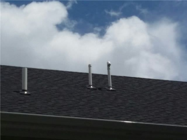

Jon Hodgkins Posted June 9, 2016 Report Share Posted June 9, 2016 I would appreciate any insight to why the pvc roof penetration, in the middle, appears to be capped. I was only able to perform an exterior inspection from the ground. The homeowner was not aware of any issues but indicated that they had problems with the contractor. The home owner also indicated that they had gas forced air heating units. My thoughts were that it might be for combustion air for the hot air furnace. Could this be anything other than a cap? I would doubt that it is a coupling. My other thought was maybe it is some type of check valve fitting that only allows air in, but I would be concerned that it would not work properly in the winter. This is new 2016 construction in Needham, MA. Thanks Click to Enlarge 27.43 KB Quote Link to comment Share on other sites More sharing options...

kurt Posted June 9, 2016 Report Share Posted June 9, 2016 My WAG.... It's the combustion air intake for the furnace, but the installer decided to pull combustion air from interior instead of the exterior (which is allowed), and they capped the pipe. What's a drone going to show that's not already apparent? Seems like the answer is to be found on the interior, not exterior. Quote Link to comment Share on other sites More sharing options...

Jerry Simon Posted June 9, 2016 Report Share Posted June 9, 2016 Could be a rough-in for a radon mitigation system; many jurisdictions around here want such for new construction. Quote Link to comment Share on other sites More sharing options...

Brandon Whitmore Posted June 10, 2016 Report Share Posted June 10, 2016 The combustion air intake for the condensing furnace should be the one facing downwards. Water shouldn't be able to enter that pipe. The "vent" should be the one with the coupling/ cap piece on it. If the vent is capped, then the pressure switch should prevent the furnace from operating, so it's highly unlikely that it is in fact capped, assuming you operated the furnace. Usually, you can see which pipe the exhaust is coming out of when it's in operation. Quote Link to comment Share on other sites More sharing options...
kurt Posted June 10, 2016 Report Share Posted June 10, 2016 I misread on my previous answer. Brandon's right; no water should get into the intake; that's a problem. Water getting into the exhaust...not really, but the amount of moisture that might actually get in is probably less than that being produced by the furnace. I need to retire..... Quote Link to comment Share on other sites More sharing options...
John Kogel Posted June 11, 2016 Report Share Posted June 11, 2016 I'll bet that 'cap' is a screen on the exhaust, but that's my guess from 4000 miles away. Make yourself a pole camera. Mine is a paint pole, paint roller handle, mini camera tripod, all done up professionally with black tape. [] Quote Link to comment Share on other sites More sharing options...
Jon Hodgkins Posted June 11, 2016 Author Report Share Posted June 11, 2016 Thanks for the responses - the screen makes sense. My inspections are for insurance. With the added information from the home owner, that they had issues with the HVAC contractor, I included a requirement to verify what the "cap" is, and to make sure the system is in proper working order. There is most likely a sensible explanation, but maybe the contractor has had issues with payment and would cut the "cap" off after receiving final payment? I use to work for a masonry contractor and would hear stories about masons installing a pane of glass between a couple of the clay flue tiles, and would drop a brick down the chimney to break the glass after they received their final payment. I will let you know what the answer is as soon as I hear back from the home owner. Quote Link to comment Share on other sites More sharing options...

plummen Posted June 16, 2016 Report Share Posted June 16, 2016 My WAG.... It's the combustion air intake for the furnace, but the installer decided to pull combustion air from interior instead of the exterior (which is allowed), and they capped the pipe. What's a drone going to show that's not already apparent? Seems like the answer is to be found on the interior, not exterior. I agree with that. Id look at the furnace and follow the pipe feeding it combustion air to see where it goes now. Quote Link to comment Share on other sites More sharing options...
Jim Katen Posted June 16, 2016 Report Share Posted June 16, 2016 I would appreciate any insight to why the pvc roof penetration, in the middle, appears to be capped. I was only able to perform an exterior inspection from the ground. The homeowner was not aware of any issues but indicated that they had problems with the contractor. The home owner also indicated that they had gas forced air heating units. My thoughts were that it might be for combustion air for the hot air furnace. Could this be anything other than a cap? I would doubt that it is a coupling. My other thought was maybe it is some type of check valve fitting that only allows air in, but I would be concerned that it would not work properly in the winter. This is new 2016 construction in Needham, MA. Thanks Click to Enlarge 27.43 KB I saw one just like it today, but was distracted and didn't take a picture. When I looked at it from the ground, it looked like a cap, but from the roof, I could see that it was a small coupler. The installer had put it there to make a small recessed space, which accommodated a metal screen. Of course, the furnace instructions said, "Don't place a screen there. . ." Quote Link to comment Share on other sites More sharing options...
