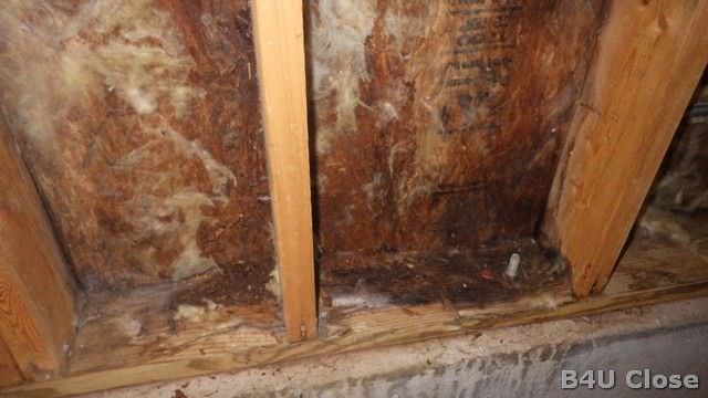

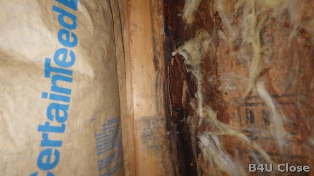

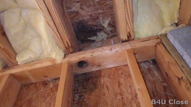

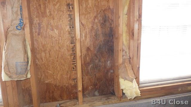

Erby Posted August 10, 2016 Report Share Posted August 10, 2016 For my learning knowledge, not the report. It's already been sent. Two story on a poured wall basement with a poured wall a couple of feet high and then a knee wall at the back of the basement. I see some water stains at the bottom of the knee wall and lift a bit of insulation to see what's going on. A bit of water damage so I then remove most of the insulation to expose the extent of the damage. It was pretty bad. Sheathing so rotten I could stick my finger through it to the brick veneer. Studs rotted away so I could put my hand between the stud and where the sheathing was supposed to be. Sill plate you could push your finger into. Yes, a water resistant barrier was installed behind the vinyl above this area. Obviously, a fault in the wall covering and flashing above. QUESTION: How the heck do you fix rotted sheathing, studs and sill plate behind a brick veneer? Click to Enlarge 47.61 KB Click to Enlarge 64.15 KB Click to Enlarge 39.87 KB Click to Enlarge 41.41 KB Click to Enlarge 47.7 KB Click to Enlarge 43.61 KB Click to Enlarge 39.65 KB Quote Link to comment Share on other sites More sharing options...
mjr6550 Posted August 10, 2016 Report Share Posted August 10, 2016 You tear off the veneer and start over because with damage like that the WRB and flashingsee need to be replaced also. Anything less is a bandaid. Quote Link to comment Share on other sites More sharing options...
Rob Amaral Posted August 10, 2016 Report Share Posted August 10, 2016 Exactly.. 'do it over'... rip off the veener.. Quote Link to comment Share on other sites More sharing options...
Marc Posted August 10, 2016 Report Share Posted August 10, 2016 The studs can be replaced one-by-one and the sheathing isn't really that important with the shear strength provided by the walls above. Replacing the sill might even be possible by supporting the two stories with a temp wall positioned a few feet from the rotted wall. But if the WRB is compromised or if large areas of sheathing must be replaced, I see no way to do it without removing the brickwork. The stain pattern suggest more of a flashing issue at the siding/veneer junction than anything else. Marc Quote Link to comment Share on other sites More sharing options...

Steven Hockstein Posted August 10, 2016 Report Share Posted August 10, 2016 We worked on a Jersey Shore home with severe termite damage behind brick veneer. The damage was discovered as part of the aftermath of Super Storm Sandy (the termite problem would not have been found for many more years if not for the need to remove the interior wall finishes). After consulting with multiple contractors about how to repair the framing, the consensus was that the best way to repair the structure was to take the veneer down. In the end, it was also the less costly option. In your case it will likely be easier to diagnose and repair the water penetration problem with the veneer removed. Quote Link to comment Share on other sites More sharing options...
kurt Posted August 10, 2016 Report Share Posted August 10, 2016 Mark (and everyone else) is right. It's a rain screen and you can't fix a rain screen without starting over because all the important stuff goes in long before the brick goes up. Quote Link to comment Share on other sites More sharing options...
