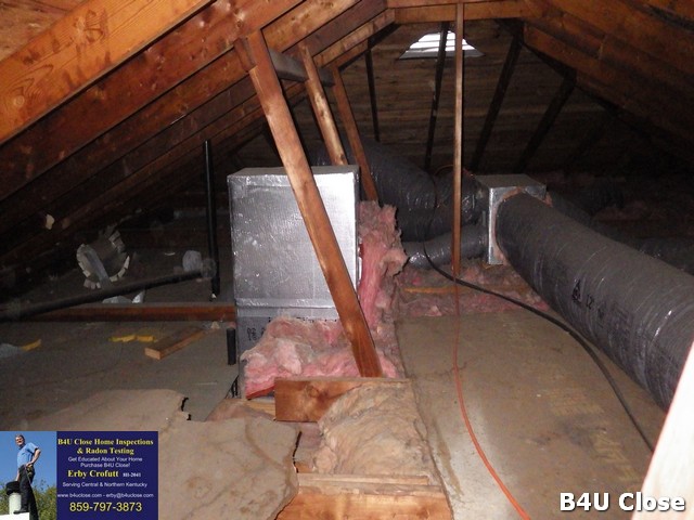

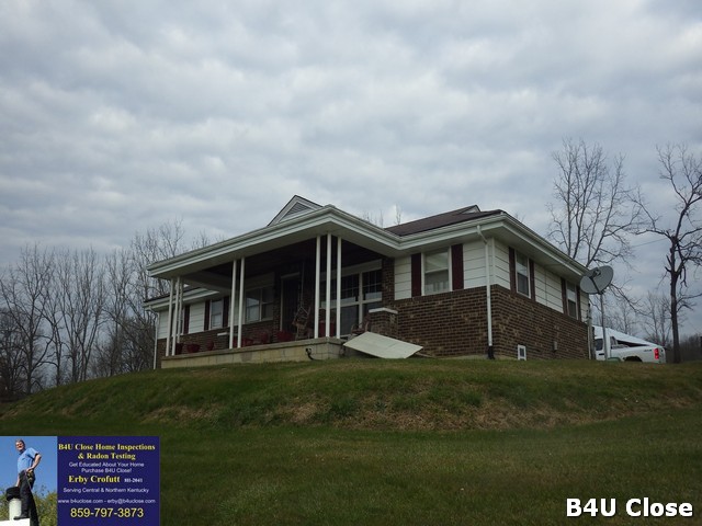

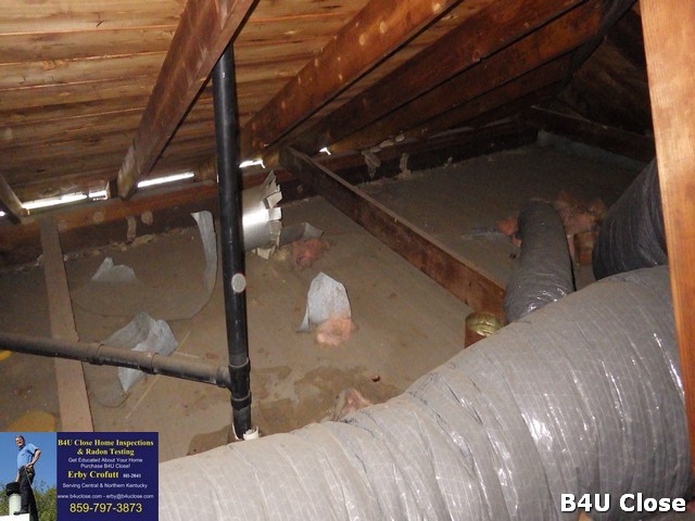

Erby Posted November 30, 2017 Report Share Posted November 30, 2017 (edited) You'd never know it from the outside but hidden in the front half of this home is an trailer house. The whole front half. Saw it as soon as I climbed up in the attic. There was that old mobile home rounded metal roof. Edited November 30, 2017 by Erby Quote Link to comment Share on other sites More sharing options...
Les Posted November 30, 2017 Report Share Posted November 30, 2017 pretty cool. attics are a pain until you find something like this! Quote Link to comment Share on other sites More sharing options...
Marc Posted November 30, 2017 Report Share Posted November 30, 2017 A stick-built attic atop an engineered HUD-Code home. How'd you write that one up? Quote Link to comment Share on other sites More sharing options...
John Kogel Posted December 1, 2017 Report Share Posted December 1, 2017 That's some skillful carpentry there. The trailer can't support the roof, so there have to be posts or walls on foundations all around, right? Were the buyers surprised at all? Just wondering what was disclosed to them when they made their offer. Quote Link to comment Share on other sites More sharing options...
Erby Posted December 1, 2017 Author Report Share Posted December 1, 2017 There were posts and a foundation all around. It was quite the surprise to the buyers and their agent. They didn't have any idea of it until I came down out of the attic. The metal beams and vapor barrier under the front half of the house confirmed the mobile home. It wouldn't surprise met that the sellers didn't know either. They hadn't been there that long! Quote Link to comment Share on other sites More sharing options...
