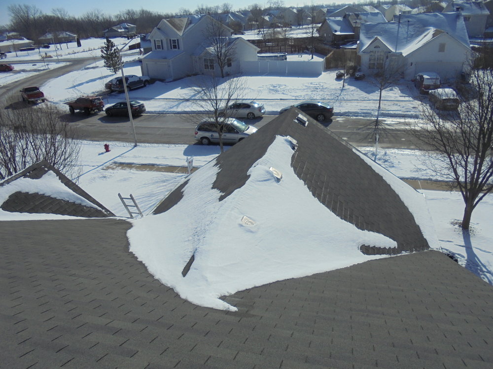

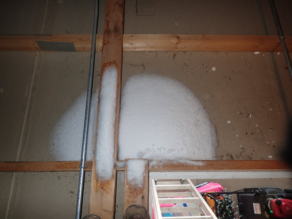

Mike Lamb Posted January 18, 2018 Report Share Posted January 18, 2018 I have only seen this once or twice before where there was a nice pile of snow beneath the roof vents. This was in an unheated attached garage attic. Would you blame severe weather and it could not be helped, or maybe they need new snow proof roof vents if there is such a thing. The roof above was mostly snow covered. Part of the house had vaulted ceilings with some moisture stains near the ridge and I speculate the same thing might be happening at the roof vents above that area as well. Quote Link to comment Share on other sites More sharing options...
Les Posted January 18, 2018 Report Share Posted January 18, 2018 nothing other than anecdotal observations. The vents look too close to ridge. We see it on houses with steep roofs, facing westerly (lake effect winds). I don't know of snow proof vents. Quote Link to comment Share on other sites More sharing options...
Tom Raymond Posted January 18, 2018 Report Share Posted January 18, 2018 See it all the time with ridge vents perpendicular to prevailing winds. Especially in rural areas. Quote Link to comment Share on other sites More sharing options...

Chad Fabry Posted January 18, 2018 Report Share Posted January 18, 2018 2 hours ago, Marc said: Mike O once mentioned some roof vents designed for high wind areas to keep the rain out. Perhaps that would work on snow also if winds were high. Windblown snow is usually like windblown dust- the flakes have been bashed about and they're very small. It's usually not a big deal because it melts and spreads through the insulation layer and the resulting huge surface area encourages rapid evaporation. The snow in Mike's picture, lacking insulation, may leave a mark. Quote Link to comment Share on other sites More sharing options...

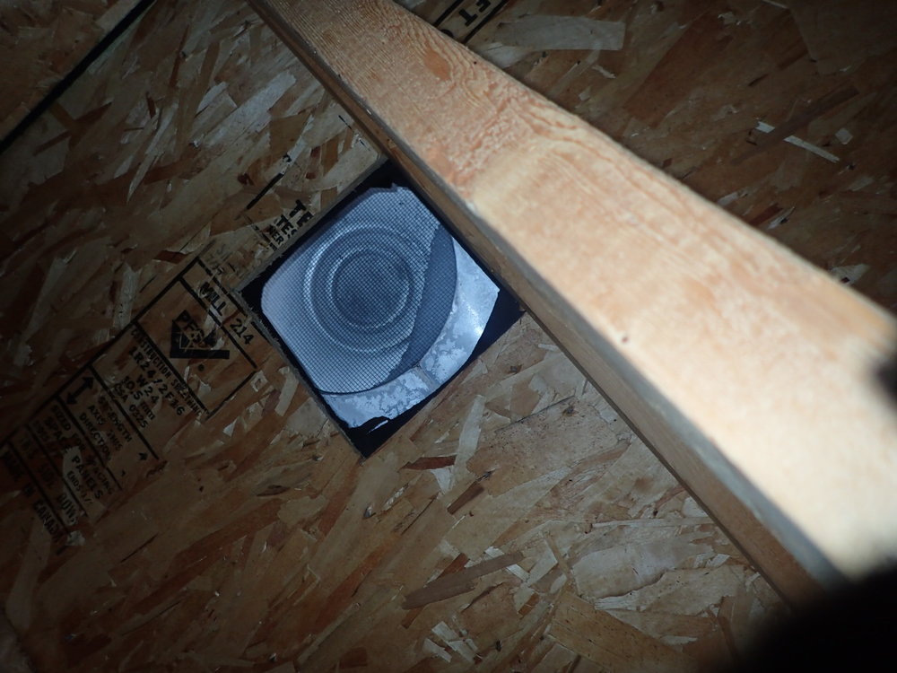

Erby Posted January 22, 2018 Report Share Posted January 22, 2018 (edited) Looks to me from the picture that the rain baffle ring and screen are out of position, leaving nothing to stop snow and animals from dropping into the attic. I've seen some installations here in Kentucky where they leave the baffle ring completely out. Edited January 22, 2018 by Erby Quote Link to comment Share on other sites More sharing options...

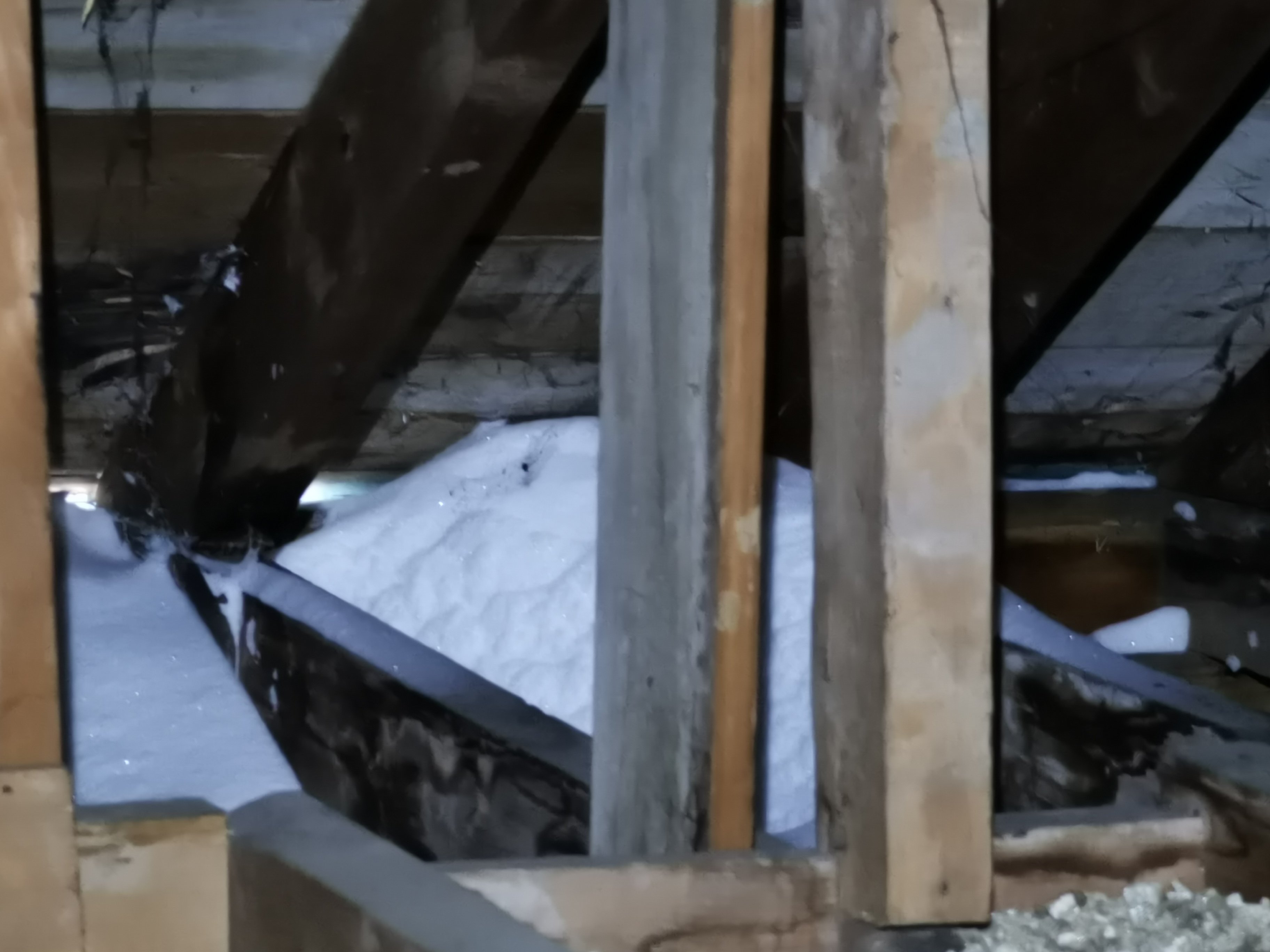

adrianf Posted February 18, 2020 Report Share Posted February 18, 2020 (edited) I see this every winter. Usually not too much snow in the attic, except for the other day when, after quite a blizzard, i found about 2 cubic feet of snow sitting in the soffit area. Probably a missing flashing at the exterior. The snow melts and evaporates rather quickly in most cases and presents no real problem. Edited February 18, 2020 by adrianf Quote Link to comment Share on other sites More sharing options...
