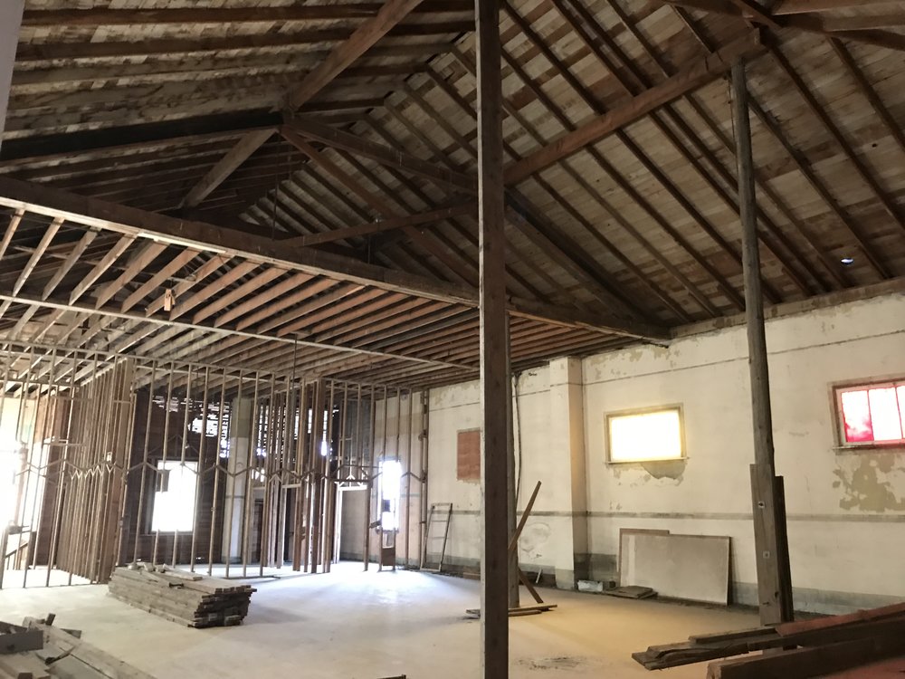

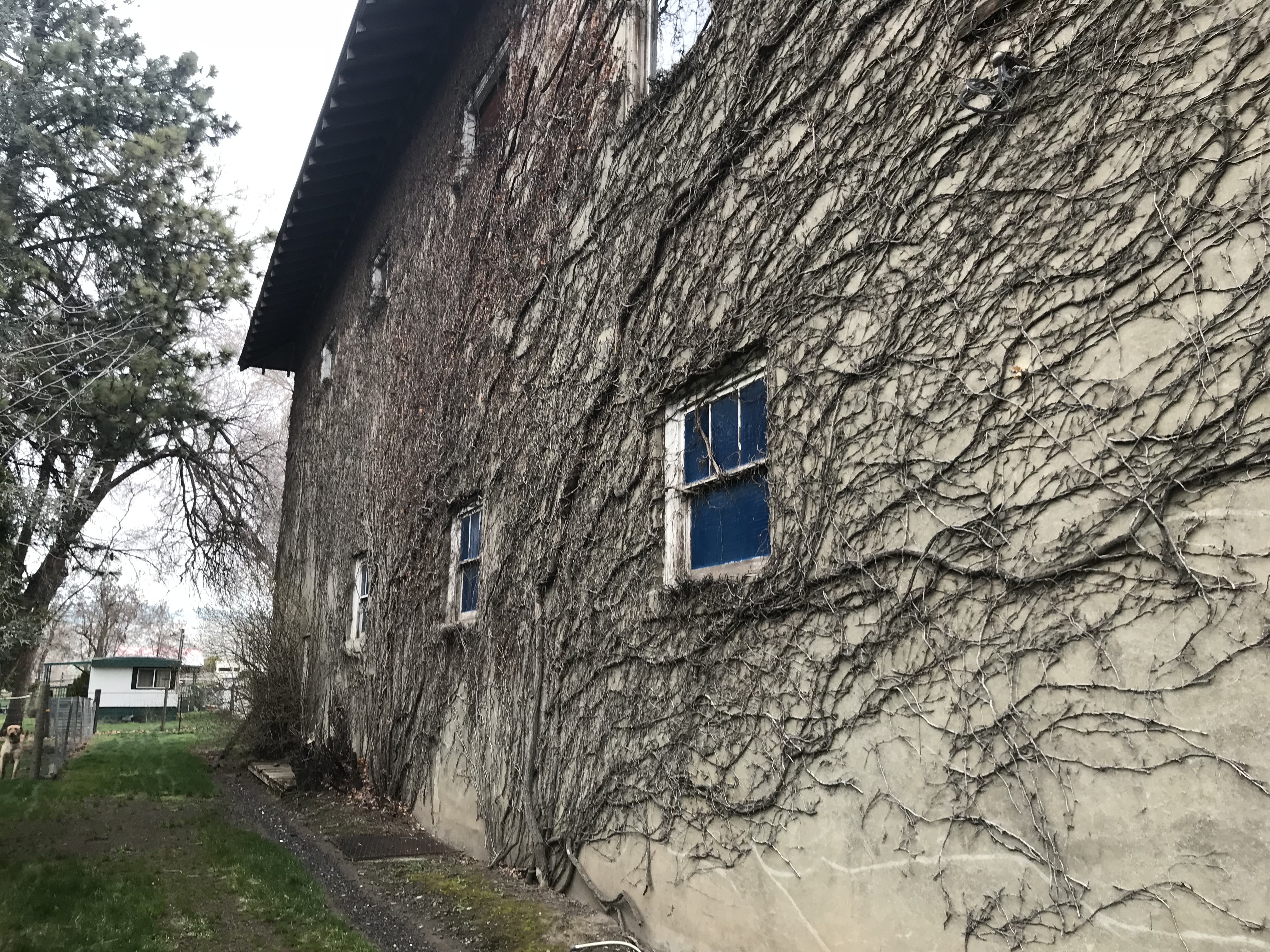

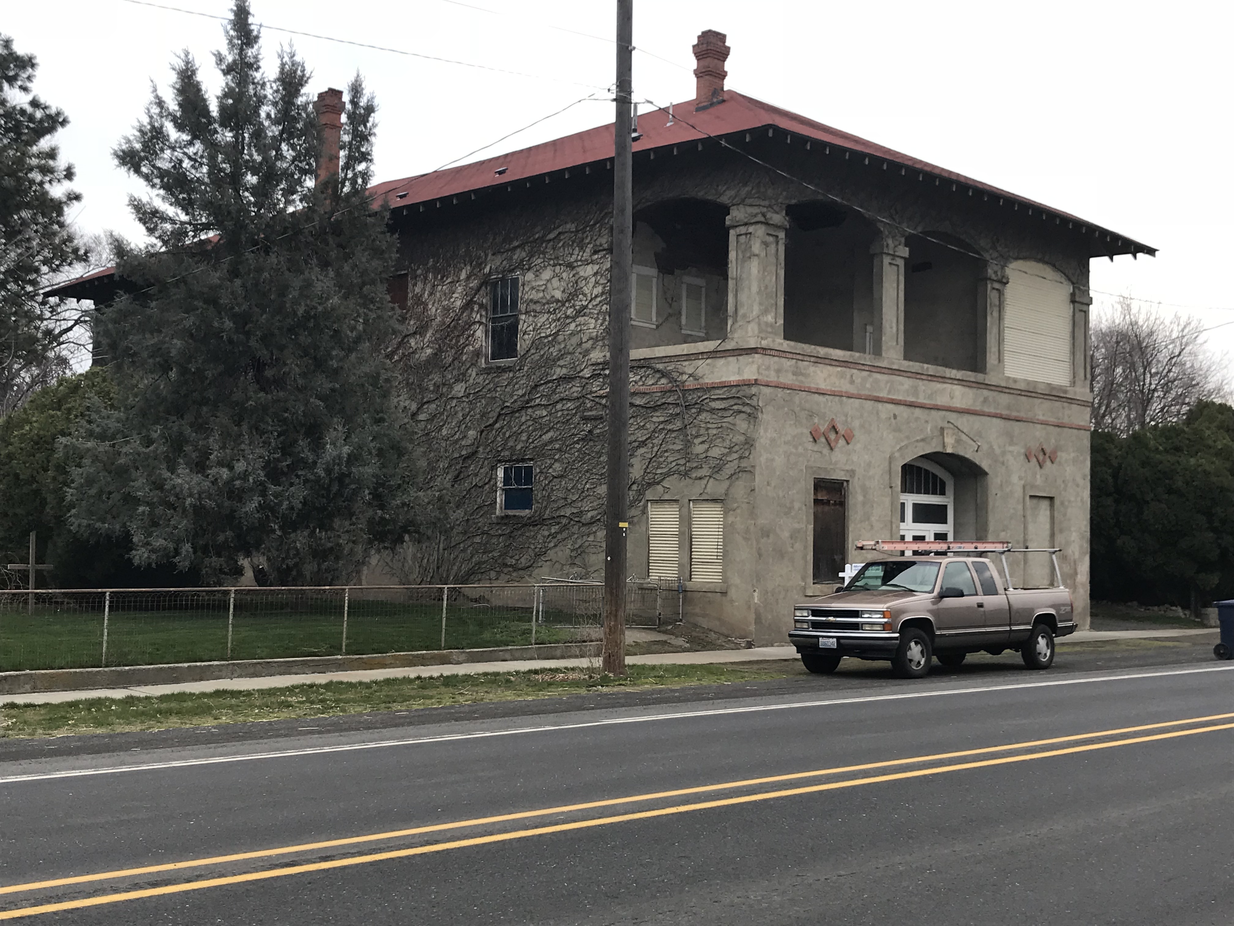

Trent Tarter Posted March 17, 2018 Report Share Posted March 17, 2018 My morning inspection was pretty cool. A former "Knights of Phythias" lodge. Place is abandoned, built in 1900's. Exterior walls are solid concrete. 1 Quote Link to comment Share on other sites More sharing options...
Jim Katen Posted March 17, 2018 Report Share Posted March 17, 2018 Very interesting. I can't recall having ever seen diagonal wall blocking like that. Any ideas why they'd do that? What the heck is the big thing sitting in front of the furnace? I've never seen a burner like that. In my little town of Gaston, the old K of P building lay abandoned for years. A guy at the bank realized that their bank account had been dormant for many years so he did some investigating and discovered that every one of the Pythians had died. After some legal wrangling, he revived the lodge, drummed up some members, fixed up the building, and they're now a strong organization in the community. Quote Link to comment Share on other sites More sharing options...
Trent Tarter Posted March 17, 2018 Author Report Share Posted March 17, 2018 1 hour ago, Jim Katen said: Very interesting. I can't recall having ever seen diagonal wall blocking like that. Any ideas why they'd do that? What the heck is the big thing sitting in front of the furnace? I've never seen a burner like that. In my little town of Gaston, the old K of P building lay abandoned for years. A guy at the bank realized that their bank account had been dormant for many years so he did some investigating and discovered that every one of the Pythians had died. After some legal wrangling, he revived the lodge, drummed up some members, fixed up the building, and they're now a strong organization in the community. I imagine the wall blocking was to help prevent old lath and plaster from cracking. The big red thing in front of furnace the "coal stoker". Quote Link to comment Share on other sites More sharing options...
Chad Fabry Posted March 17, 2018 Report Share Posted March 17, 2018 I was looking at the diagonal blocking too. My first thought was, "that's a good idea, it's easier to nail". It's also possible they had a bunch of cut-offs from some other aspect of construction and rather than cut two ends square they just cut the other end at an angle. Very cool building. I'm a little jealous of the buyer. Quote Link to comment Share on other sites More sharing options...

Jim Katen Posted March 17, 2018 Report Share Posted March 17, 2018 5 hours ago, Chad Fabry said: I was looking at the diagonal blocking too. My first thought was, "that's a good idea, it's easier to nail". It's also possible they had a bunch of cut-offs from some other aspect of construction and rather than cut two ends square they just cut the other end at an angle. It looks like it much harder to nail. Think about it. You nail off one side first. Then when you go to nail off the other side, the force of the hammer hitting the diagonal cut drives the stud outward and instead of 16" oc spacing, you've now got 16-1/4" spacing. What a pain. Square-cut blocking ensures even spacing. Quote Link to comment Share on other sites More sharing options...

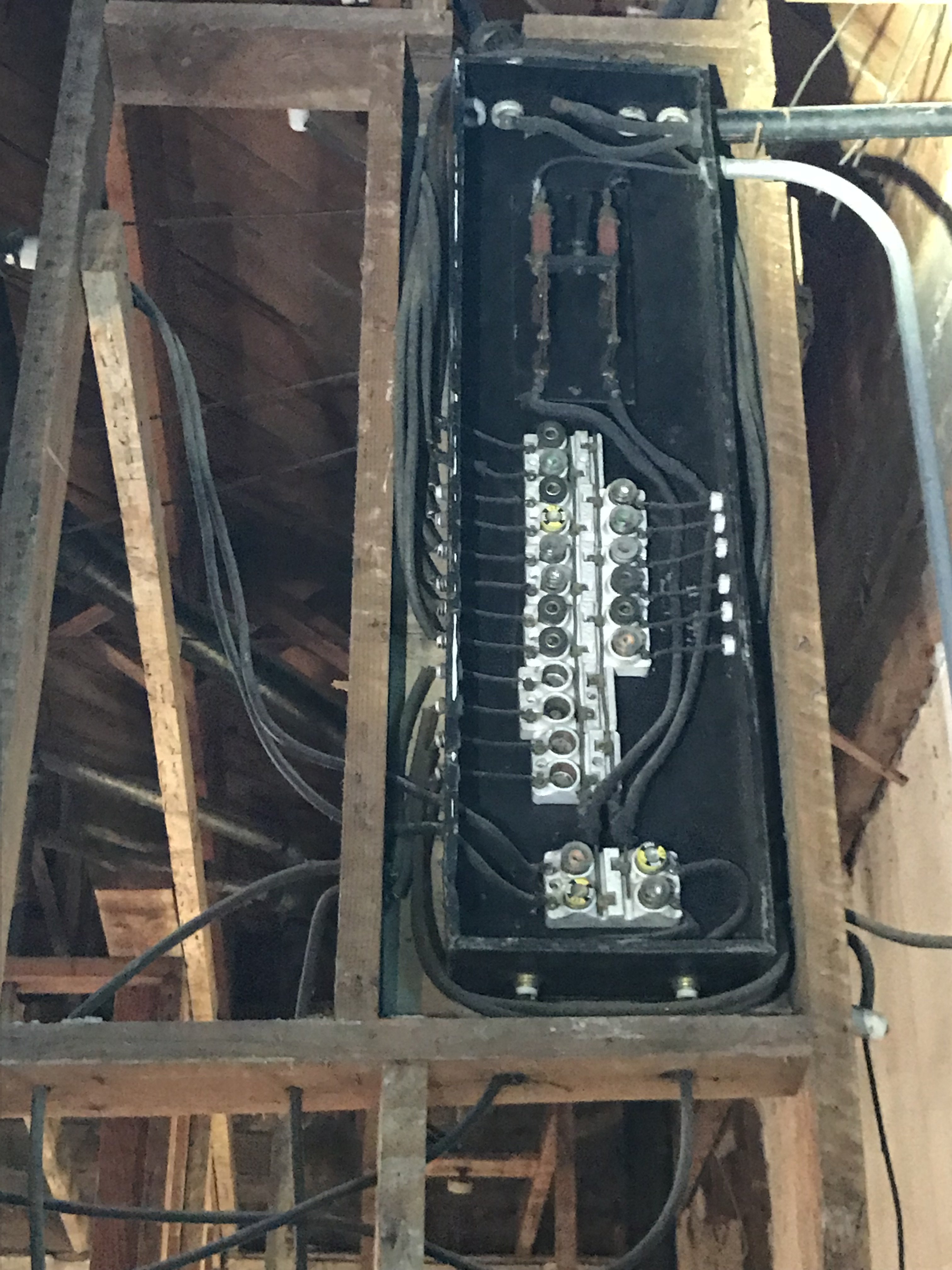

Trent Tarter Posted March 17, 2018 Author Report Share Posted March 17, 2018 At least the electrical inspection was easy. Has two new 200 amp service panels with one 20 amp circuit , building has a single light and receptacle only. Had one of the largest fuse panels I've seen. Quote Link to comment Share on other sites More sharing options...
