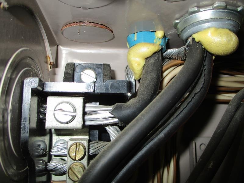

Tom Breslawski Posted June 30, 2018 Report Share Posted June 30, 2018 My guts says "no." Can I get a confirmation? Thanks! Quote Link to comment Share on other sites More sharing options...
Jim Katen Posted July 1, 2018 Report Share Posted July 1, 2018 At the very least, they should remove the portion of the foam that's inside the enclosure. Is the whole wall filled with foam? Quote Link to comment Share on other sites More sharing options...
Tom Raymond Posted July 1, 2018 Report Share Posted July 1, 2018 I bet all the work boxes look like that. When I foamed my addition I taped the boxes to avoid this. Quote Link to comment Share on other sites More sharing options...
Tom Breslawski Posted July 2, 2018 Author Report Share Posted July 2, 2018 (edited) On 6/30/2018 at 11:57 PM, Jim Katen said: At the very least, they should remove the portion of the foam that's inside the enclosure. Is the whole wall filled with foam? The wall is fiberglass, not foam. The foam was sprayed in the penetrations only. I told them to remove the foam inside the enclosure. Thanks. Edited July 2, 2018 by Tom Breslawski Quote Link to comment Share on other sites More sharing options...
