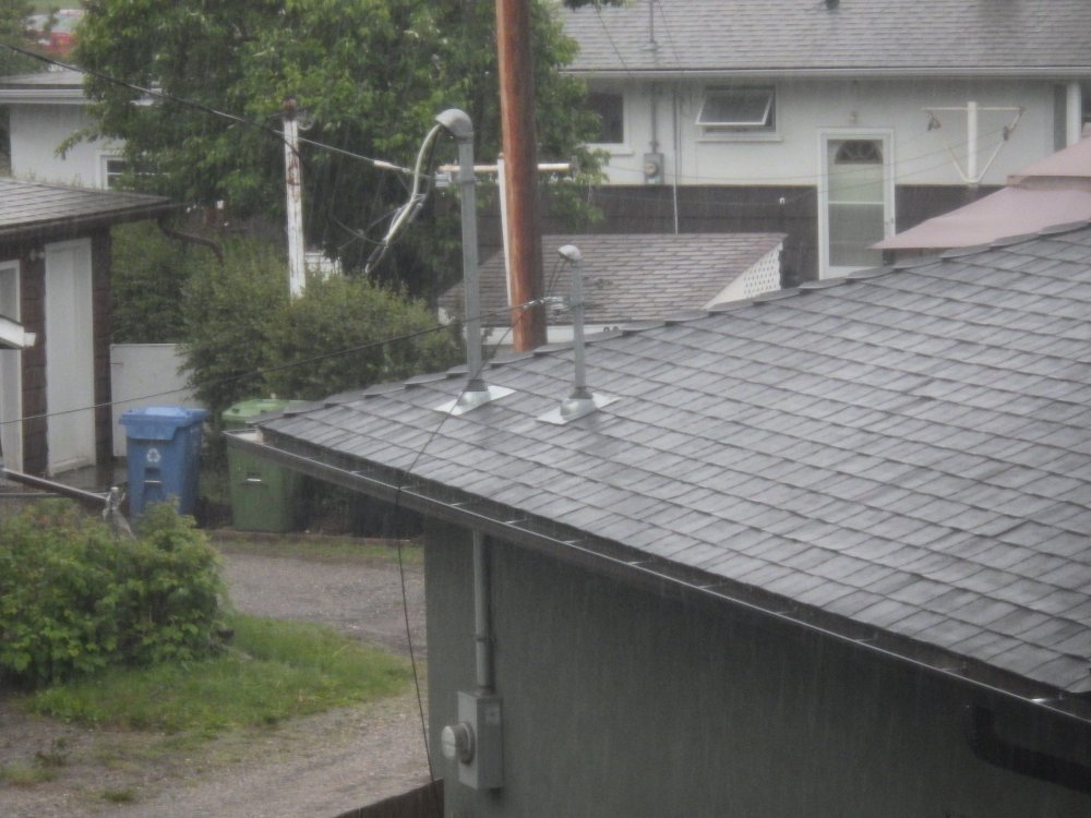

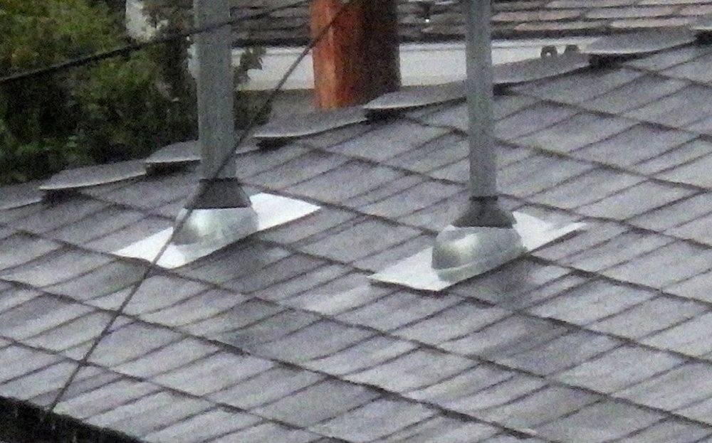

ejager Posted November 3, 2018 Report Share Posted November 3, 2018 Interesting how things vary from location to location. The metal base kind went out of fashion for plumbing stacks a while ago here in favour of the all rubber, and that more frequently now its the newer thermo-plastic base with minimal rubber around the stack only (https://www.oatey.com/2375038/Product/Oatey-Thermoplastic-No-Calk-Roof-Flashings-Standard-Base_ Still see the metal base with rubber for electrical masts, sometimes more than we should. 😄 Quote Link to comment Share on other sites More sharing options...
Jim Katen Posted November 3, 2018 Report Share Posted November 3, 2018 I like the way they just sit on top of the shingles in the happy-go-lucky, carefree way. 1 Quote Link to comment Share on other sites More sharing options...
DCBuildings Posted December 11, 2018 Report Share Posted December 11, 2018 Actually, if the original flashing was cracked, then sliding new flashing down on top of it like these pictures would generally fix the water intrusion in most cases, possibly getting years more life for the cost of the $5 boot. Toss in a little silicone between the boots and Bob's your uncle. You could even cut the flats off the 2nd boot, and just slide the bell down with caulk... if you don't like the happy-go-lucky appearance Quote Link to comment Share on other sites More sharing options...
Marc Posted December 11, 2018 Report Share Posted December 11, 2018 7 hours ago, DCBuildings said: Actually, if the original flashing was cracked, then sliding new flashing down on top of it like these pictures would generally fix the water intrusion in most cases, possibly getting years more life for the cost of the $5 boot. Toss in a little silicone between the boots and Bob's your uncle. You could even cut the flats off the 2nd boot, and just slide the bell down with caulk... if you don't like the happy-go-lucky appearance Sort of like the flashing/counter-flashing concept, but I still wouldn't do it. I like clean, straightforward construction. Quote Link to comment Share on other sites More sharing options...
Bill Kibbel Posted December 11, 2018 Report Share Posted December 11, 2018 7 hours ago, DCBuildings said: Actually, if the original flashing was cracked, then sliding new flashing down on top of it like these pictures would generally fix the water intrusion in most cases, possibly getting years more life for the cost of the $5 boot. Toss in a little silicone between the boots and Bob's your uncle. You could even cut the flats off the 2nd boot, and just slide the bell down with caulk... if you don't like the happy-go-lucky appearance Repair collars, without the flange, are available. Quote Link to comment Share on other sites More sharing options...
