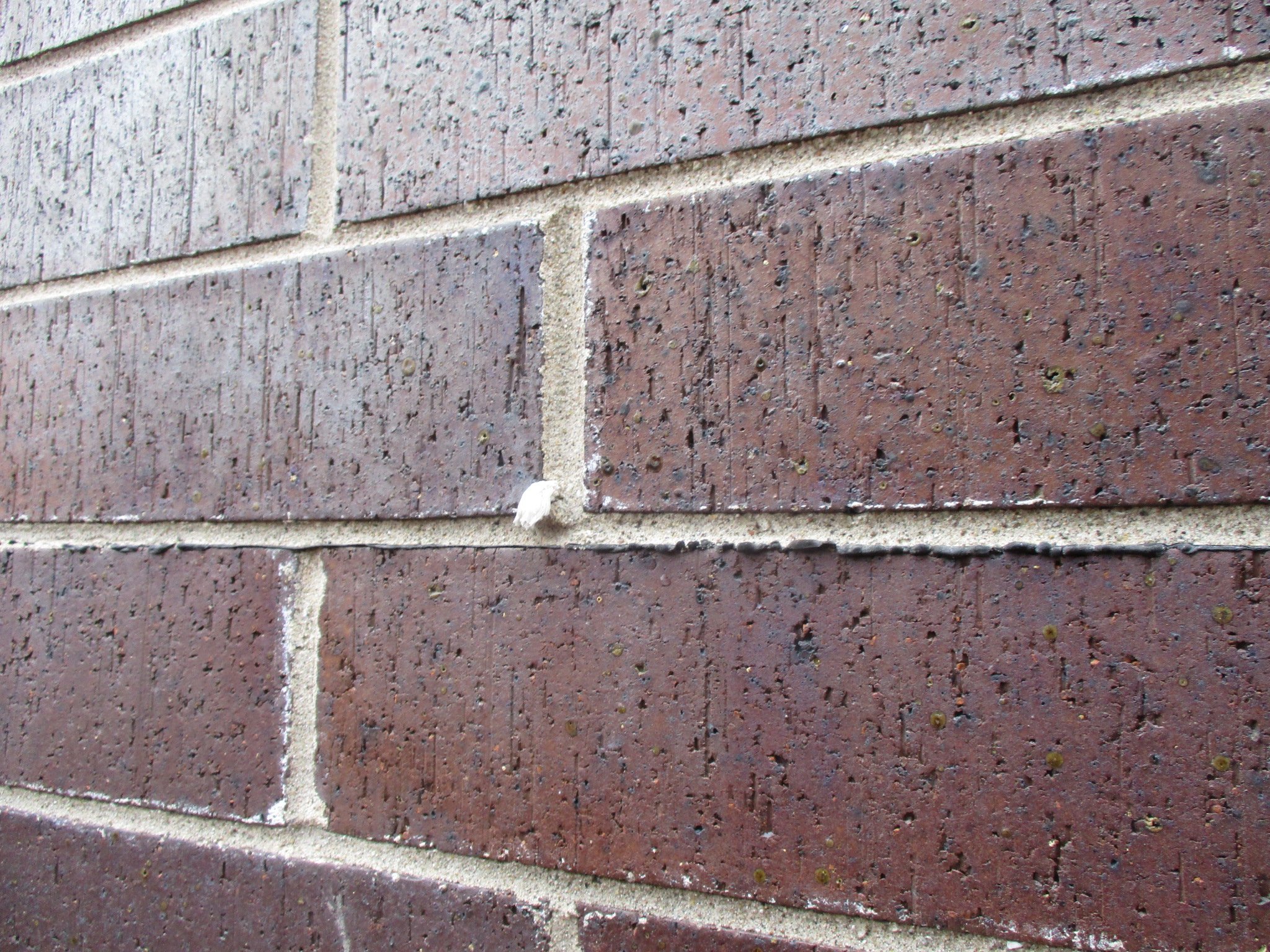

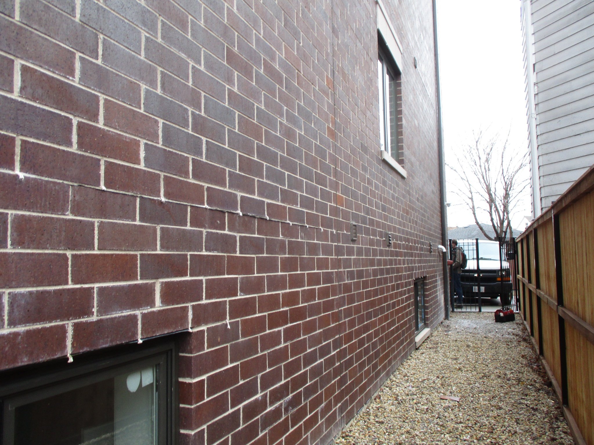

Mike Lamb Posted February 12, 2019 Report Share Posted February 12, 2019 Does anyone have a drawing from a reputable source detailing flashing/weeps at structural floors? IRC 1405.4.2 Masonry. Flashing and weep holes in anchored veneer shall be located in the first course of masonry above finished ground level above the foundation wall or slab, and other points of support, including structural floors, shelf angles and lintels where anchored veneers are designed in accordance with Section 1405.6. Quote Link to comment Share on other sites More sharing options...

Mike Lamb Posted February 14, 2019 Author Report Share Posted February 14, 2019 Thanks all. I still don't see any specific drawings relating directly to flashing details at a floor intersection for a wood frame home with brick veneer. Quote Link to comment Share on other sites More sharing options...
RK52 Posted February 14, 2019 Report Share Posted February 14, 2019 I’m thinking it is the same as near the base of the wall where flashing might be used. This page shows a through-wall flashing details adjacent to floor joists. By the text, it looks to me that the flashing method is to be repeated at each floor level. Figs. 2, 5 & 8 present examples that may apply. Quote Link to comment Share on other sites More sharing options...
HomeInspectionNewark Posted September 24, 2019 Report Share Posted September 24, 2019 On 2/14/2019 at 11:11 AM, RK52 said: I’m thinking it is the same as near the base of the wall where flashing might be used. This page shows a through-wall flashing details adjacent to floor joists. By the text, it looks to me that the flashing method is to be repeated at each floor level. Figs. 2, 5 & 8 present examples that may apply. I would agree with you here. Interesting setup but I think you have the right thought process. -- Sterling Quote Link to comment Share on other sites More sharing options...
