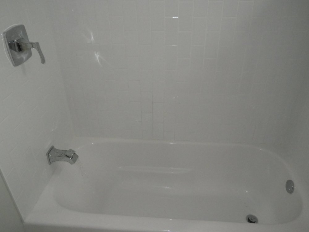

Jerry Simon Posted July 16, 2019 Report Share Posted July 16, 2019 New construction. Good grief. . . 1 Quote Link to comment Share on other sites More sharing options...
Marc Posted July 17, 2019 Report Share Posted July 17, 2019 Is there a showerhead? Quote Link to comment Share on other sites More sharing options...
Jim Katen Posted July 17, 2019 Report Share Posted July 17, 2019 Interesting. Is it a problem? If so, why? Quote Link to comment Share on other sites More sharing options...
Bill Kibbel Posted July 17, 2019 Report Share Posted July 17, 2019 3 minutes ago, Jim Katen said: Interesting. Is it a problem? If so, why? I think folks that take baths might like to sit back and relax. It's probably more comfortable ifn all the protruding bits are at one end. Quote Link to comment Share on other sites More sharing options...
Jim Katen Posted July 17, 2019 Report Share Posted July 17, 2019 2 minutes ago, Bill Kibbel said: I think folks that take baths might like to sit back and relax. It's probably more comfortable ifn all the protruding bits are at one end. I didn't consider that. Since becoming an adult, I've never sat in a bathtub. Quote Link to comment Share on other sites More sharing options...
Jerry Simon Posted July 17, 2019 Author Report Share Posted July 17, 2019 11 hours ago, Marc said: Is there a showerhead? Yes, with no way to easily reach the shower valve/faucet while sitting in the tub. Quote Link to comment Share on other sites More sharing options...
Jerry Simon Posted July 17, 2019 Author Report Share Posted July 17, 2019 9 hours ago, Jim Katen said: Interesting. Is it a problem? If so, why? Hard to see in the pict, but the sloped back of the tub, where your back would comfortably lie against, is under the tub spout. Quote Link to comment Share on other sites More sharing options...
Jerry Simon Posted July 17, 2019 Author Report Share Posted July 17, 2019 9 hours ago, Jim Katen said: I didn't consider that. Since becoming an adult, I've never sat in a bathtub. I'm betting that's true for about 50% of the population. I like to relax and read a book in the tub. My wife thinks it's gross to use a bathtub (or a hot tub, spa, etc.). Quote Link to comment Share on other sites More sharing options...
Marc Posted July 17, 2019 Report Share Posted July 17, 2019 4 hours ago, Jerry Simon said: Yes, with no way to easily reach the shower valve/faucet while sitting in the tub. Dumb builder. It happens. You wrote it up? Quote Link to comment Share on other sites More sharing options...
Mycakers Posted July 18, 2019 Report Share Posted July 18, 2019 Could there have been a shower stall installed in the bath previously? I've heard a few stories about rehabers not relocating a drain properly when doing a remodel. Quote Link to comment Share on other sites More sharing options...
Bill Kibbel Posted July 18, 2019 Report Share Posted July 18, 2019 1 hour ago, Mycakers said: Could there have been a shower stall installed in the bath previously? I've heard a few stories about rehabers not relocating a drain properly when doing a remodel. That's often the case with this type of installation but, Jerry stated this to be new construction. 1 Quote Link to comment Share on other sites More sharing options...
Jim Baird Posted July 19, 2019 Report Share Posted July 19, 2019 During the remodel the headwall stayed the same but the drain got relocated probably due to structural issues from a long time leak etc. The guy doing the job was not going to be living with it. Quote Link to comment Share on other sites More sharing options...
