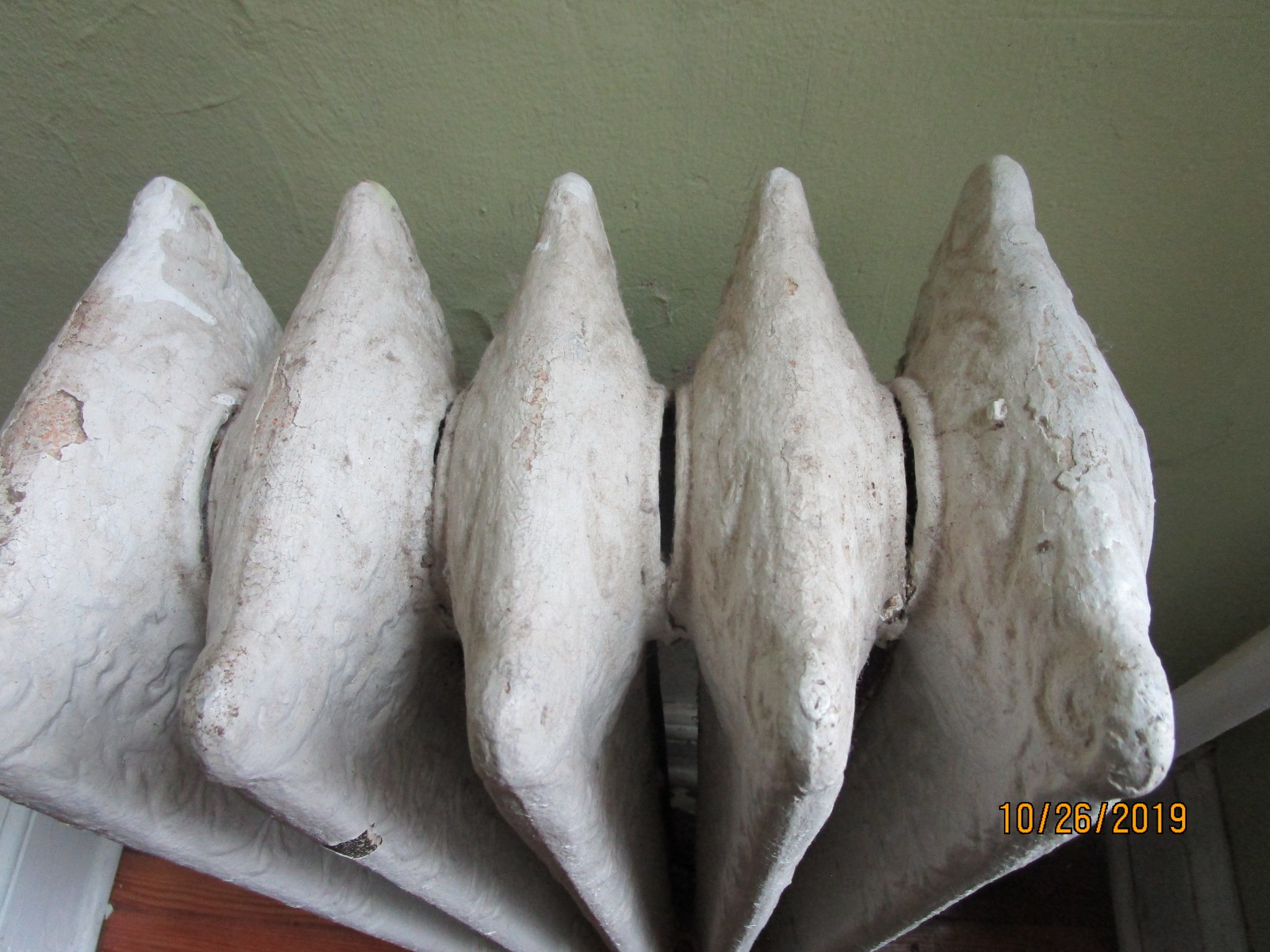

Daniel Dodge Posted October 29, 2019 Report Share Posted October 29, 2019 On Saturdays inspection, I observed openings on the top of the radiators about 1/8" wide around the top half where the sections connect. This is new to me. Quote Link to comment Share on other sites More sharing options...
Bill Kibbel Posted October 29, 2019 Report Share Posted October 29, 2019 Could be that the water in the radiator froze - expanded. That type of radiator doesn't have the threaded rods at the top. It doesn't always result in a leak. There are smaller diameter nipples inside those openings that insert into adjacent radiator sections. 1 Quote Link to comment Share on other sites More sharing options...
