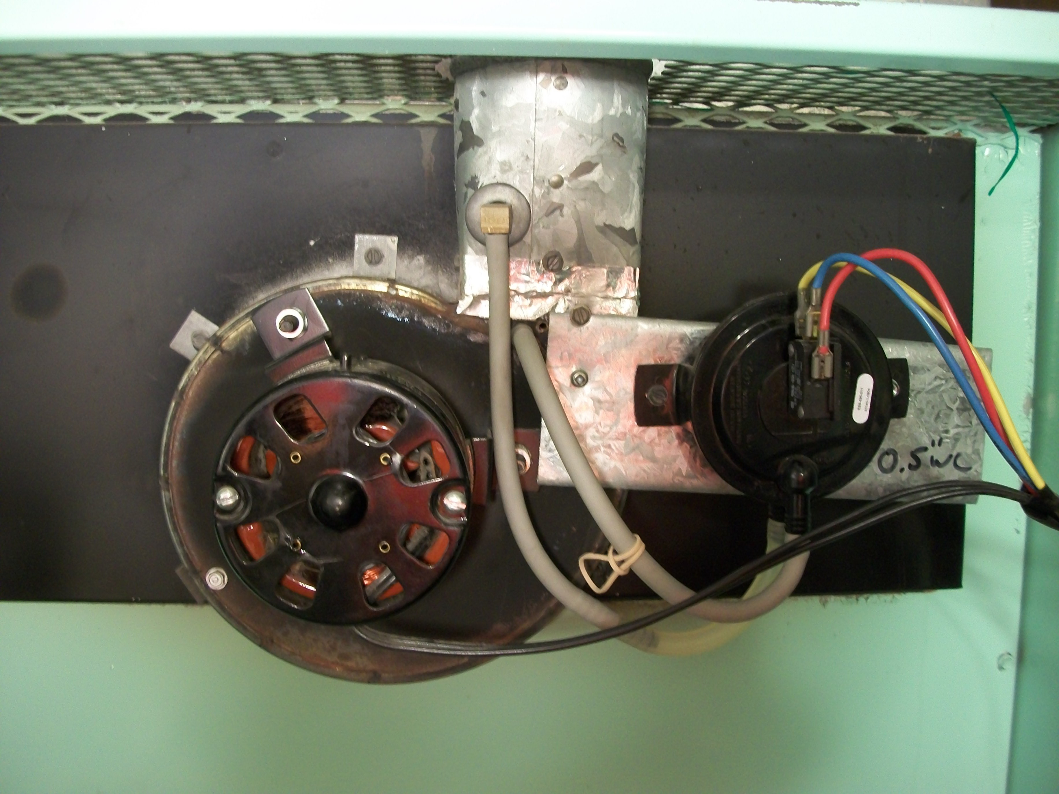

Bruce Cahoon Posted November 13, 2019 Report Share Posted November 13, 2019 (edited) This furnace was installed in 1985 as part of construction of a new R 2000 home. It still heats the house fine. However at startup the burners are on for only about 20 seconds and after about 3 seconds the burners are on again for only about 6 seconds and for the rest of the heating cycle the burners are on for about 2 seconds the off for about 3 seconds. If I squeeze tightly the white plastic tube with the rubber band around it (see image), the burners stay on as one would expect. We have cleaned the flame detector. Edited November 14, 2019 by Bruce Cahoon re wprding Quote Link to comment Share on other sites More sharing options...
Marc Posted November 13, 2019 Report Share Posted November 13, 2019 I'm not sure which tube you're referring to but I suspect those two white tubes are involved in proving that the inducer fan is working before allowing the burners to ignite by checking for a partial vacuum at the inducer fan suction. Normal atmospheric pressure at the suction is taken as meaning that the fan isn't working. Quote Link to comment Share on other sites More sharing options...
Jim Katen Posted November 13, 2019 Report Share Posted November 13, 2019 What Marc said. The pressure switch is trying to prove negative pressure in the flue. I'd start by looking for an obstruction in the flue and checking to be sure that the furnace room has an ample supply of combustion air. If those are both fine, then I'd test the pressure switch (or just replace it - they're cheap enough). Quote Link to comment Share on other sites More sharing options...
Marc Posted November 14, 2019 Report Share Posted November 14, 2019 (edited) 2 hours ago, Jim Katen said: What Marc said. The pressure switch is trying to prove negative pressure in the flue. I'd start by looking for an obstruction in the flue and checking to be sure that the furnace room has an ample supply of combustion air. If those are both fine, then I'd test the pressure switch (or just replace it - they're cheap enough). Another thing is to check for an air leak on the suction side. Edited November 14, 2019 by Marc Quote Link to comment Share on other sites More sharing options...
Les Posted November 14, 2019 Report Share Posted November 14, 2019 What Marc and Jim said and check both tubes for moisture. Pull them off on the low side while unit is idle. Quote Link to comment Share on other sites More sharing options...
Bruce Cahoon Posted November 14, 2019 Author Report Share Posted November 14, 2019 18 hours ago, Marc said: I'm not sure which tube you're referring to but I suspect those two white tubes are involved in proving that the inducer fan is working before allowing the burners to ignite by checking for a partial vacuum at the inducer fan suction. Normal atmospheric pressure at the suction is taken as meaning that the fan isn't working. Thank you for your response!! Of the 2 white/grey tubes connecting the flow points near the fan motor with what I believe is the pressure switch, one of them has a rubber band around it. When I 'finger close' the tube with the rubber band, the burners function properly. When I finger close the other tube, all burner activity ceases. The fan and the ducts to it seem to work properly. I am unable to find a pressure switch designed for this furnace. I am told that parts are not available to this furnace. How do I find the right pressure switch to use? If I should want to replace the fan motor ( preventative maintenance) would it be necessary to replace the fan motor and pressure switch as a 'matched pair'? Quote Link to comment Share on other sites More sharing options...
Marc Posted November 14, 2019 Report Share Posted November 14, 2019 (edited) 42 minutes ago, Bruce Cahoon said: Thank you for your response!! Of the 2 white/grey tubes connecting the flow points near the fan motor with what I believe is the pressure switch, one of them has a rubber band around it. When I 'finger close' the tube with the rubber band, the burners function properly. When I finger close the other tube, all burner activity ceases. The fan and the ducts to it seem to work properly. I am unable to find a pressure switch designed for this furnace. I am told that parts are not available to this furnace. How do I find the right pressure switch to use? If I should want to replace the fan motor ( preventative maintenance) would it be necessary to replace the fan motor and pressure switch as a 'matched pair'? Why not just replace the rubber band and try it again. Try a hose connector in lieu of a rubber band. Edited November 14, 2019 by Marc Quote Link to comment Share on other sites More sharing options...

Bruce Cahoon Posted November 14, 2019 Author Report Share Posted November 14, 2019 The rubber band is only used to distinguish between the 2 hoses. I will replace the two hoses and try again. Can you give me any guidance as to the replacement pressure Gage? The one displayed in the picture is the first try at a replacement and is already suspect (after about 2 years) as part of the problem. Quote Link to comment Share on other sites More sharing options...
Jim Katen Posted November 14, 2019 Report Share Posted November 14, 2019 Is this a condensing furnace? If you remove the non-rubber-band hose and suck on it, does the furnace work properly? (It should - for as long as you can hold the suction.) If this is a replacement pressure switch, how did you choose it? Do its markings match those on the original switch? Who wrote 0.5" wc near the switch? This stands for 1/2" water column and might be a guide to choosing a new switch. Quote Link to comment Share on other sites More sharing options...
Bruce Cahoon Posted November 15, 2019 Author Report Share Posted November 15, 2019 Thank you Marc, Jim and Les for your responses! This is not a condensing furnace. When it was installed the builder called it a high efficiency furnace. The conbustion chamber is not sealed, but it has an intake 'flue' from an outside wall for combustion. A furnace service specialist installed the replacement pressure switch, but the furnace still had an on/off cycle (burners stayed on for about 20 to 30 seconds which was not much of an improvement). I did get a rough measurement of the CFM of the combustion fan motor - between 13 and 18 CFM. So I do not believe the problem is this motor. Would a WC number higher or lower cause the burners to stay on longer?? Thanks again! Quote Link to comment Share on other sites More sharing options...
Jim Katen Posted November 15, 2019 Report Share Posted November 15, 2019 1 hour ago, Bruce Cahoon said: This is not a condensing furnace. When it was installed the builder called it a high efficiency furnace. The conbustion chamber is not sealed, but it has an intake 'flue' from an outside wall for combustion. I only ask because the pressure switch has two tubes, which seems unusual if it's a regular furnace. The 2nd tube leads to what looks like a collector box that you'd find on a condensing furnace. I know that in the '80s manufacturers experimented with some odd configurations, so this might be one of those. Do you have a picture of the data plate, which would show the "category" of the furnace and several other technical details? 2 hours ago, Bruce Cahoon said: I did get a rough measurement of the CFM of the combustion fan motor - between 13 and 18 CFM. So I do not believe the problem is this motor. Who suggested that the problem would be with the motor? (It's called a draft inducer, by the way.) The purpose of it is to draw a regulated amount of air over the burners and into the heat exchanger. After the flames ignite, the buoyancy of their hot air draws them up and out of the flue. The draft inducer has nothing to do with pushing the gases up and out of the flue. When the furnace is operating properly, the pressure inside the flue is less than the pressure outside the flue or in that collector box (or whatever it is) behind the draft inducer. If there's no negative pressure in the flue, the pressure switch senses this and shuts down the flame. Since that pressure switch has been changed and is still cutting out the flame, its reasonable to assume that it's just doing its job and that there might be a problem with the flue: an obstruction perhaps or some other condition that's preventing the buoyant gases from rushing up the flue. 2 hours ago, Bruce Cahoon said: Would a WC number higher or lower cause the burners to stay on longer?? No. I was just wondering who wrote it and whether it's a spec for the switch or if it was a measurement of the actual pressure in the flue. Quote Link to comment Share on other sites More sharing options...

Les Posted November 15, 2019 Report Share Posted November 15, 2019 the bracket that holds the pressure switch sure looks field fabricated to me. it has different fasteners than the remainder of cabinet shown in photo; raw edges, fasteners, discoloration at throat of inducer, etc. the burner cycle you describe is of concern. I really can't imagine aftermarket parts not being available. Maybe things are different in Canada. Quote Link to comment Share on other sites More sharing options...
