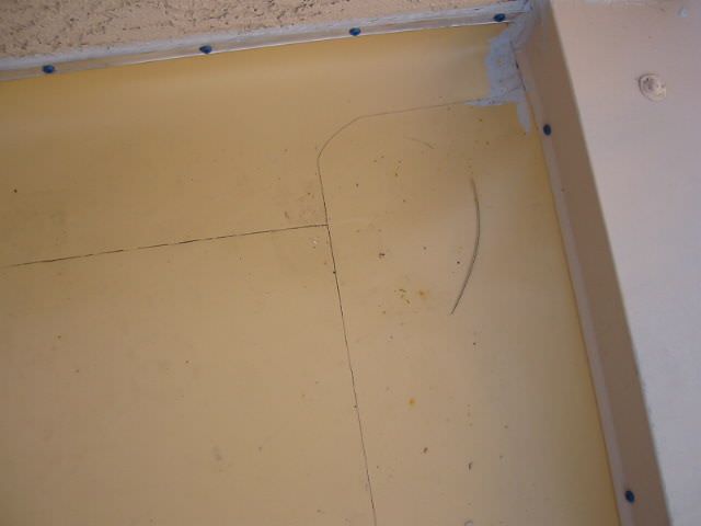

swarga Posted January 29, 2004 Report Share Posted January 29, 2004 I did an inspection today on a 1998 home that had an addition installed sometime after that. The addition has a flat roof with what appears to be a vinyl cap sheet. It is tan with small fibers embedded into it in a small diamond pattern. Photos are attached. Has anyone seen this before. Any information will be helpful. I leaving to go do a google search after I post this. Download Attachment: Picture 037.jpg 50.52 KB Download Attachment: Picture 038.jpg 87.17 KB Download Attachment: Picture 041.jpg 88.37 KB Quote Link to comment Share on other sites More sharing options...
swarga Posted January 29, 2004 Author Report Share Posted January 29, 2004 Hey, I found it.[:-graduate] http://www.azom.com/details.asp?ArticleID=1028#_Background Im surprised I've never seen this before. The site says it's been around for 40 years. Quote Link to comment Share on other sites More sharing options...
hausdok Posted January 29, 2004 Report Share Posted January 29, 2004 Hi Scott, Without going to look at the site, it looks like it is a fabric-reinforced PVC membrane. I see them here every once in a while, although I've never run into one that was that color. They're actually welded together with heat and are custom made off-site, using finite measurements taken from the roof. Everything, including the plumbing vents usually gets covered here and those things are stretched like a drumhead over the roof and fastened around the perimeter. Around here, they're a popular option for seniors to re-roof their manufactured homes. ONE TEAM - ONE FIGHT!!! Mike Quote Link to comment Share on other sites More sharing options...
Ralph Smith Posted February 7, 2004 Report Share Posted February 7, 2004 Hi Mike - Scott, This is definatly a type of nylon reinforced PVC single ply membrane. Comes in 5', 7', 10, 20' x 50' or 100'rolls. Can be fastened mechanically or adhered. Larger rolls are usally ballested with large round gravel. Quote Link to comment Share on other sites More sharing options...
Tiny Posted February 27, 2008 Report Share Posted February 27, 2008 That system is a duro-last roofing product. but the details are not spec it looks like hagpog.[:-paperba Quote Link to comment Share on other sites More sharing options...
BornaRoofer Posted March 21, 2008 Report Share Posted March 21, 2008 Its definitly a pvc/tpo type roof. I don't believe its a durolast though. Durolast has factory seams,drain inserts(inverted boots) and one way vents. I don't see any of those on this roof. The seams on durolast also have the name molded into the factory seams. Quote Link to comment Share on other sites More sharing options...
