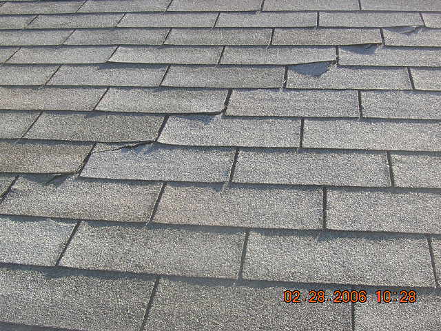

rlskfoster Posted March 2, 2006 Report Share Posted March 2, 2006 What could cause this type of damage. The shingles are torn at the same angle all over the roof. There was some foundation movement but not much more than typical for around here and it was only in one corner. The attic structure that I could see looked good with no pulled rafters and supported spans with purlins. The home has several vaulted ceiling ceilings so alot of the framing was not visible. The roof was bad and buyer is asking for a new one, but, I am curious about the cause. Buster Download Attachment: Bailey 2 026.jpg 112.34 KB Download Attachment: Bailey 2 020.jpg 108.82 KB Download Attachment: Bailey 2 025.jpg 109.53 KB Quote Link to comment Share on other sites More sharing options...

Brian G Posted March 2, 2006 Report Share Posted March 2, 2006 Weird. The way they line up does suggest a larger movement, but how? How many lines were there like that? Brian G. Bumfuzzled [:-boggled Quote Link to comment Share on other sites More sharing options...
DonTx Posted March 2, 2006 Report Share Posted March 2, 2006 The other shingles are curling at the corners. How old did the Sellers say it was? Usually when I see a roof like this, it takes very little effort to pull them up. My guess would be the foundation or some weird installation problem. What was the roof decking? Quote Link to comment Share on other sites More sharing options...

rlskfoster Posted March 2, 2006 Author Report Share Posted March 2, 2006 The house was built in 1991 and I'm figuring the original roof. The tears were for the most part in the same direction diagonally and it was like this over the entire roof. House was about 2000 sf under roof. There was an active leak in two locations. We have been in a drought for a while but last weekend we got 3 inches of rain over 48 hours. The carpet was even wet in one location. I was even wondering if the whole frame of the house could have twisted as the one corner dropped but I have seen a whole lot more movement than this house has and the roofs don't look like this one. Oh well it may just be a head scratcher! I advised a new roof and an Engineer to look at the one corner. Thanks, Buster Quote Link to comment Share on other sites More sharing options...
Bob White Posted March 2, 2006 Report Share Posted March 2, 2006 This may be a goofy thought, but I' guessing that there's no underlayment -- That can do weird things to shingle as they attach themselves to the roof decking --- Quote Link to comment Share on other sites More sharing options...
Tom Corrigan Posted March 2, 2006 Report Share Posted March 2, 2006 This is a common and warrantable defect in fiberglass matt roof shingles from 1985-1991. Further info is available at: http://www.inspect-ny.com/welcome.htm#roofing Tom Corrigan Quote Link to comment Share on other sites More sharing options...
rlskfoster Posted March 2, 2006 Author Report Share Posted March 2, 2006 Tom, This looks exactly like what has happened to the shingles in question. In fact, some of the pictures at the web-site could be swapped with my pictures and nobody would know the difference. I have made my client aware and he is going to look into the situation. I appreciate the response because I learned something new today. Thanks, Tom! Buster Quote Link to comment Share on other sites More sharing options...

mgbinspect Posted March 10, 2006 Report Share Posted March 10, 2006 A word to the wise, (from a previous disaster restoration contractor who had to figure this stuff out all the time to detirmine what was a "covered loss"), take the time to lift a few tabs. I'm reasonably confident that you will find that this roof is improperly fastened (either high, missing or overdriven fasteners) That eventually allows considerable stress to be applied to the sealed shingle tabs as the system at large expands and contracts with temperature changes. Do check for this along the cracked shingles! I've seen systems that were only fastened by two instead of four nails! They were naturally cracked all to #@*. It is far more likely that this is an attachment problem than a material problem. Good luck! Quote Link to comment Share on other sites More sharing options...
homnspector Posted March 10, 2006 Report Share Posted March 10, 2006 "Could it be the adhesive strip bonds too well and doesn't permit expansion without tearing the tabs?" Thats the explanation I have heard from 2 different roofers. Basically a shingle defect, too much adhesion. Quote Link to comment Share on other sites More sharing options...
Rob Amaral Posted March 11, 2006 Report Share Posted March 11, 2006 That is indeed the Corrigan shingle defect. He's right. The shadow profile confirms the relative age, the diagonal cracking is a classic evidence of the 'fiberglass mat shingle defect' very common in this type of shingle. Looks like multiple layers as well. May just be occurring at certain poorly-ventilated areas, like vaulted-ceiling areas. "Tear-off/replace". Could start showing up at other areas. Very well documented problem. Absent other info in this inspector's post, this is what is looks like to me. Quote Link to comment Share on other sites More sharing options...

StevenT Posted April 1, 2006 Report Share Posted April 1, 2006 I know that fiberglass mat shingle is prone to cracking. But if that were the case, wouldn't the cracking be more "scattered" or over a larger area? The cracking in the picture seems to be continuous and seems to have a point of origin and termination. Is this what fiberglass mat cracking looks like? Is there a possibility that the sheathing is not properly attached or some other movement, maybe in conjunction with the fiberglass? Quote Link to comment Share on other sites More sharing options...
Jim Katen Posted April 1, 2006 Report Share Posted April 1, 2006 Originally posted by StevenT I know that fiberglass mat shingle is prone to cracking. But if that were the case, wouldn't the cracking be more "scattered" or over a larger area? The cracking in the picture seems to be continuous and seems to have a point of origin and termination. Is this what fiberglass mat cracking looks like? Is there a possibility that the sheathing is not properly attached or some other movement, maybe in conjunction with the fiberglass? No, it's unlikely that it's related to sheathing movement. If it were, you'd see a pattern that resembled the 4x8 sheets of sheathing. The diagonal pattern is typical of matt failure -- at least that's what I frequently see. If you look carefully, you can see that it follows the ends of each three-tab section as they stair-step up the roof. My guess is that once one tab tears, it relieves stress on itself, but then imposes stress on the one above or below it and the pattern of failure marches along. If my theory were correct, then I'd expect to see vertical tearing patterns on roofs that were installed using the racking method. - Jim Katen, Oregon Quote Link to comment Share on other sites More sharing options...
