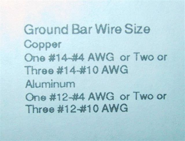

Jim Katen Posted March 3, 2006 Report Share Posted March 3, 2006 Originally posted by Donald Lawson I've been told that it is wrong to double different sizes of ground wires up under single set screws at the ground bus. I often find #14 and #12's paired up as well as #10 and #14's. As I was told, only grounds of the same size and material can be doubled/tripled up under single set screws at the ground bus. Can someone give me the NEC code for this? The NEC section would be 110.3(b), the one that says you have to follow the equipment instructions. Like Richard said, RTFM. The attached picture is from my ITE panel. Download Attachment: ITE Ground Term.JPG 51.8 KB As I read it, you can put a #10 a #12 and a #14 under the same lug. - Jim Katen, Oregon Quote Link to comment Share on other sites More sharing options...
Brian G Posted March 3, 2006 Report Share Posted March 3, 2006 I think you can read that either way. It looks very ambiguous to me. It doesn't indicate that they have to be the same, or that they can't be different. Lousy directions. On a common sense level putting two different size wires under the same screw is bad practice. It would be easy to get good contact on one but not the other. Maybe if they were twisted together tightly first... Brian G. What We Got Here, Is a Failure to Communicate (clearly) Quote Link to comment Share on other sites More sharing options...
DonTx Posted March 6, 2006 Author Report Share Posted March 6, 2006 Now I know where I saw it..... ....the last sentence Download Attachment: IMG_7217.jpg 49.68 KB Quote Link to comment Share on other sites More sharing options...
