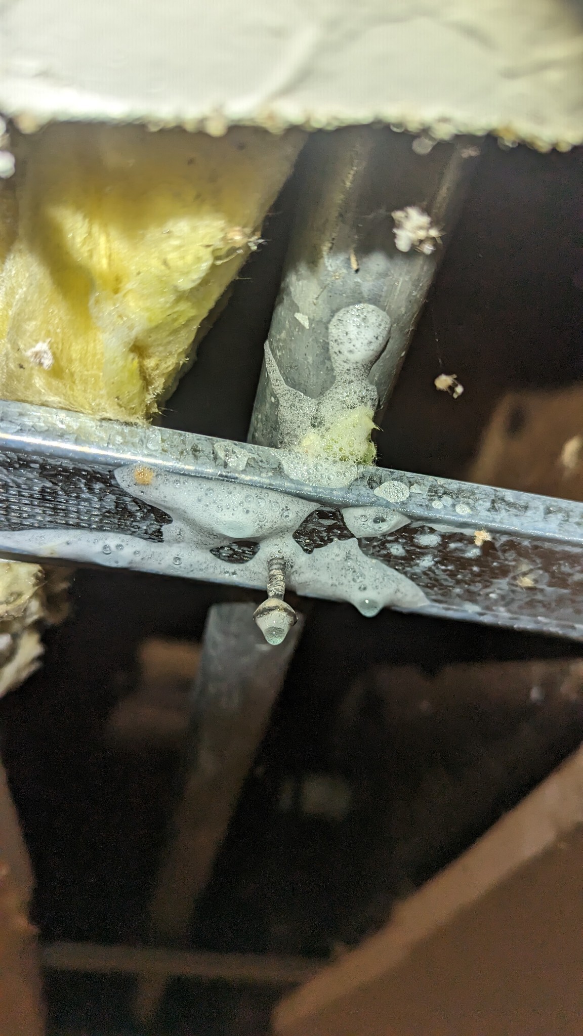

Denray Posted February 10, 2023 Report Share Posted February 10, 2023 They checked every fitting and still leaked. When all quiet he could hear a slight noise. Cut hole in drywall and ran his fingers down the pipe. Drywall screw thru drywall support bracket into pipe. 1 Quote Link to comment Share on other sites More sharing options...
Marc Posted February 11, 2023 Report Share Posted February 11, 2023 It's a pain in the neck to sleuth these things sometimes. Quote Link to comment Share on other sites More sharing options...
