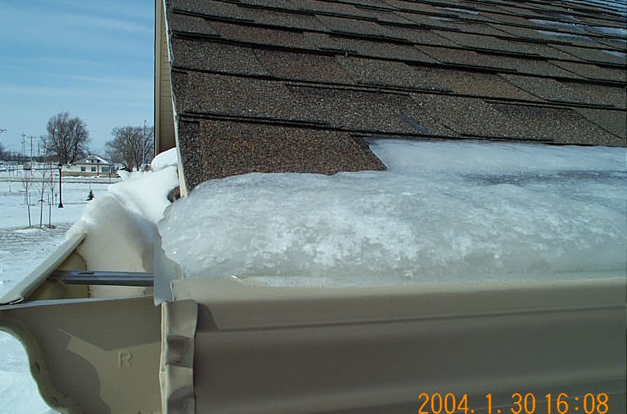

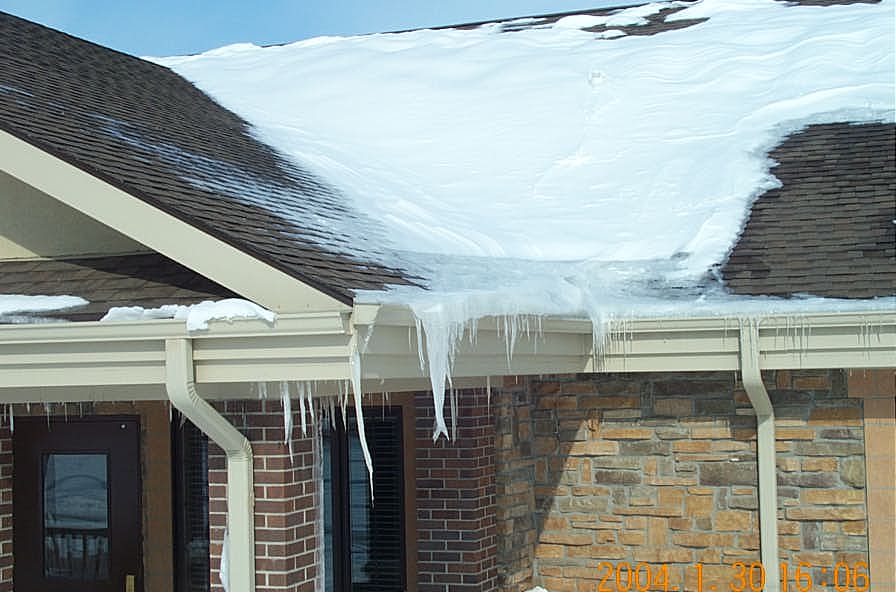

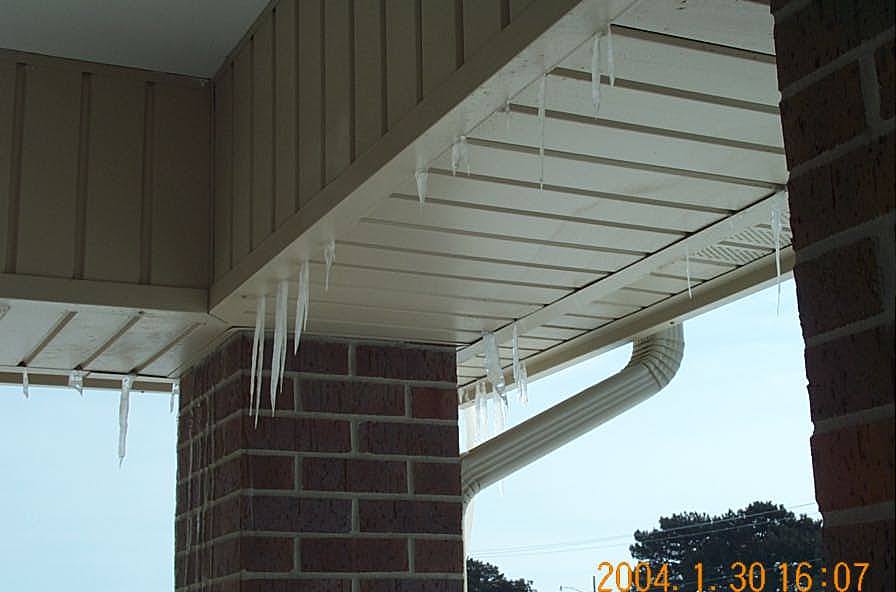

Konrad Posted February 2, 2004 Report Share Posted February 2, 2004 For those of you in the south that don't see this kind of thing, this is a pretty good ice dam. There is water getting into the wall cavities. [:-sick] Download Attachment: DCP_9151.JPG 69.03 KB Download Attachment: DCP_9153.JPG 59.88 KB Download Attachment: DCP_9152.JPG 48.78 KB Quote Link to comment Share on other sites More sharing options...

Chad Fabry Posted February 3, 2004 Report Share Posted February 3, 2004 Well, I was going to try and post a pic. I'll come back later when I can get it to 80kb or less. It's no trouble, I'll put it on a pc with xp, modify it, copy it install it here on my coal burner and upload it. You'll all get to see the ice dam photo sometime in May. Mike Brown technical genius saves the day... Here's what happens in NY when bath fans are vented through the soffit Download Attachment: icedam1.jpg 51.6 KB Quote Link to comment Share on other sites More sharing options...
