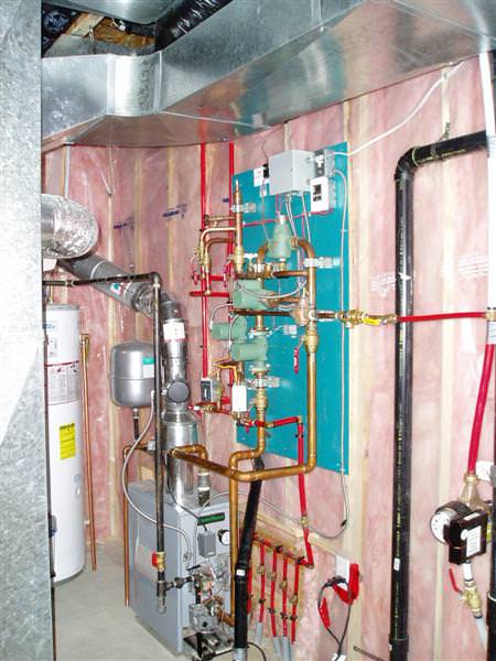

The in slab radiant piping is mostly PEX although I've see a few Poly B systems and I recommend to monitor closely.
Copper and brass controls are seen from the manifold to the boiler.
I have to admit that radiant is relatively new for us and reserved for higher end homes. For the most part, systems are less than 20 years old and perhaps the reason we don't see failures yet.
I agree wholeheartedly about the importance of reaming the copper system. Turbulence and as you say eddies can wreak havoc not to mention reduce efficiency and volume.
Here is a typical installation
Download Attachment: icon_photo.gif HeatingBoiler_M.jpg
66.76 KB
FYI- PEX come in different colors- for identification purposes only
Red - for hot
Blue - for cold
White - for both
