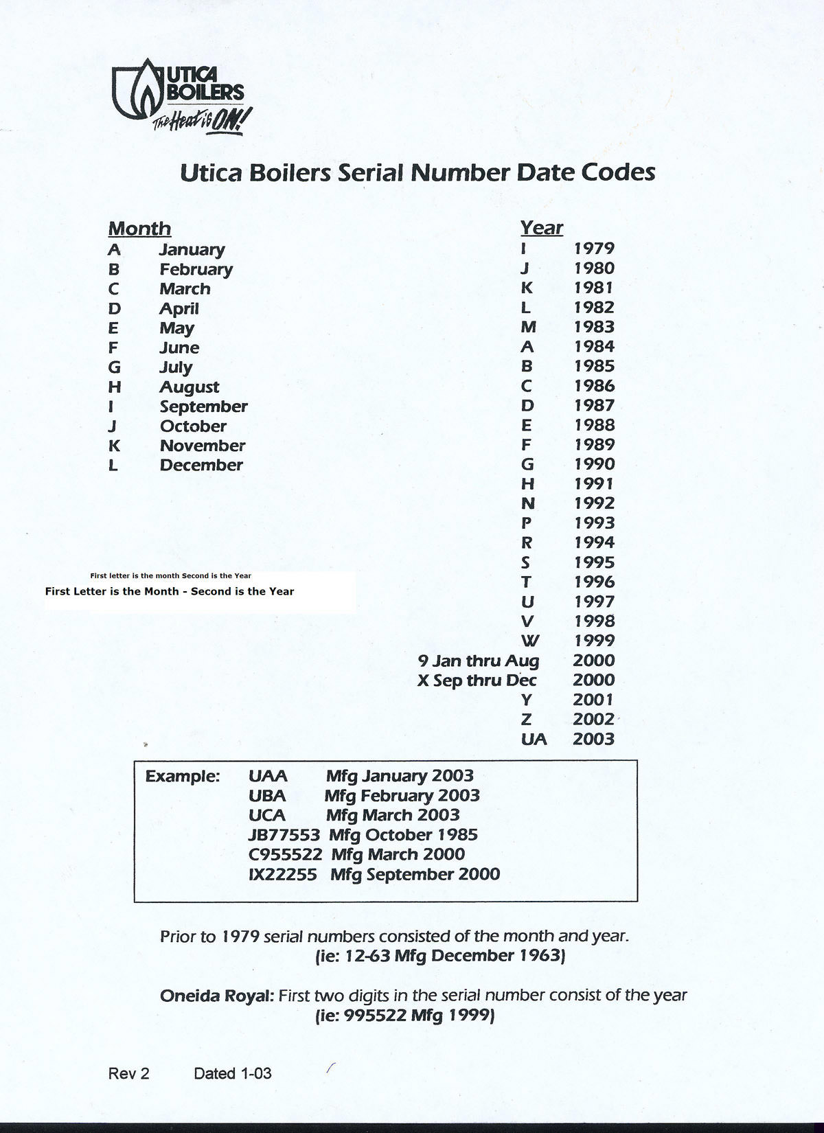

Kyle Kubs Posted May 19, 2007 Report Share Posted May 19, 2007 Mike, Did anything ever come of this? You know, with all your spare time helping us schleps figure out which way is up... If this is something your still working on; Smith Boilers The serial # will start with a letter followed by 3-5 Numbers. The first two numbers following the letter are the year of Manufacture. Smith started in 1853 Pensotti - Italian Made The Date is cast into the front of the heat exchanger. On the back section there will be a code that will read 15.11.96 or 15.11.1996 Depending on when the boiler was made it will also have the code on the front leg area or just below the cleanout cover. That number stands for November 15, 1996. (there is a removable plate on the jacket) Weil-Mclain you have to call them and ask for the tech dept - Give them the CP # on the data plate or sticker. (219)879-6561 Utica See the attached .jpg file -Ok it won't load. - Email me if you need it Peerless The last four digits of the Serial are the MMYY General Electric (Old) American Standard Quote Link to comment Share on other sites More sharing options...

hausdok Posted May 19, 2007 Report Share Posted May 19, 2007 To load a .jpg photo, resize it to less than 100 Kb and then rename it without any symbols in the name or spaces. In other words kyles house(downtown) needs to be KylesHouseDowntown or Kyles_House_Downtown or something similar. Then it will load. However, if you are using Firefox or Netscape, you may need to upload it to the upload window and then cut and paste the URL to the photo into your post. I'd still like to do this, but I didn't get a whole lot of input on it as you can see. I'll be happy to pass it off to anyone that wants to tackle it. OT - OF!!! M. Quote Link to comment Share on other sites More sharing options...
Kyle Kubs Posted May 19, 2007 Report Share Posted May 19, 2007 Ok - Lets try this again. I hadit, or at least I thought it was, within all the parameters. Opened it in photoshop and the image size shows as a lot bigger then the computer is saying it is. Does'nt make sense, but I decreased it's size a bit. Download Attachment: UticaBoilers.JPG 257.57 KB Success! Quote Link to comment Share on other sites More sharing options...
hausdok Posted May 19, 2007 Report Share Posted May 19, 2007 Thank Kyle, That's great. Now, if only all of the hundreds of folks bogarting those various cheat sheets out there were to do that we might be able to come up with a pretty comprehensive single document and put it in the downloads section for everyone to use. Oh, by the way, I've got to get around to updating the water heater serial number decoder, because AO Smith Water Heaters has gobbled up State, Reliance, Maytag, American and GSW since I first published that. (Grrrr, leave it to some kajillion dollar corporation to make more work for me.). OT - OF!!! M. Quote Link to comment Share on other sites More sharing options...
