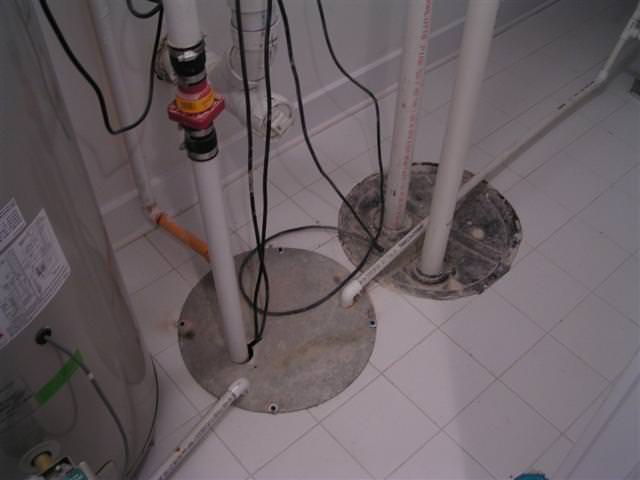

Shooter Mike Posted July 27, 2006 Report Share Posted July 27, 2006 Okay, I grew up in central Ohio. We had a basement, but I never paid much attention to what was down there. For all of my adult life, I've lived in coastal areas that don't have basements, or even crawlspaces for that matter. Anyway, reading through the book and it's talking about foundation drainage systems. If I walk into a basement where do I begin to look for a sump drain? In all reality, I'll probably never see a basement, but still want to know all of the particulars. Like GI Joe says...knowing is half the battle. Semper Fi - Mike Quote Link to comment Share on other sites More sharing options...
kurt Posted July 28, 2006 Report Share Posted July 28, 2006 Here's a quick pic of what a foundation drain & an ejector system would look like in the inner City. Download Attachment: sumps small.jpg 33.41 KB Quote Link to comment Share on other sites More sharing options...

Les Posted July 28, 2006 Report Share Posted July 28, 2006 Mike, Kurt and Terry are correct, however it is all about words when you are talking about sumps and pumps. For instance, Terry suggests "basement waterproofing systems" for search term. Sumps and pumps can be a part of basement waterproofing systems, however foundation drainage systems and moisture control systems are two other terms commonly used and they are not the same. Most modern houses (40yrs)will have a footing drainage system and some will have a sump to collect the water and some will have a pump to discharge the water. Kurt is showing you a sump with pump on the left and a sump with pump on the right, but they are very different; left handles ground water from footing drain and right one handles sewage (grinds it and ejects it). Left is an open system that should discharge to atmosphere and right is sealed and should discharge to sanitary sewer. From inspection viewpoint, you need to know the proper configurations, safety features, components and what they are actually doing. It is real simple - but can be very complicated and can certainly get you in a world of trouble as an inspector. I review about a hundred+- inspections per year for litigation and the mis-use of terms and functions of these systems is quite common and frustrating. Oh ya - throw in the fact some radon mitigation guys use the sump for a collection point and use same electrical circuit, piping, etc.. Seen several radon systems installed in ejector sumps. Please do not take this response as a complete answer, just a little carping about our business. There is lots of stuff here on TIJ and the net. Quote Link to comment Share on other sites More sharing options...
Chad Fabry Posted July 28, 2006 Report Share Posted July 28, 2006 Mike, The guys that answered are the best in the business, but for folks like me a simpler explanation is sometinmes helpful. 1)Permeable layer (usually sone/gravel) under basement slab. 2)Drain tile in ditch around perimeter of basment, and exterior of foundation covered with stone and leading to the sump/crock/collection point. Drain tile is like flexible abs plastic that's been perforated..it creates an unobstructed conduit for water to flow. 3)All grading beneath stone pitches to crock/sump/collection point. 4) Water runs down hill. When the sump is full of water a pump kicks on and pumps it out of the basement...preferably to a neighbor's yard or other suitable area. Quote Link to comment Share on other sites More sharing options...
