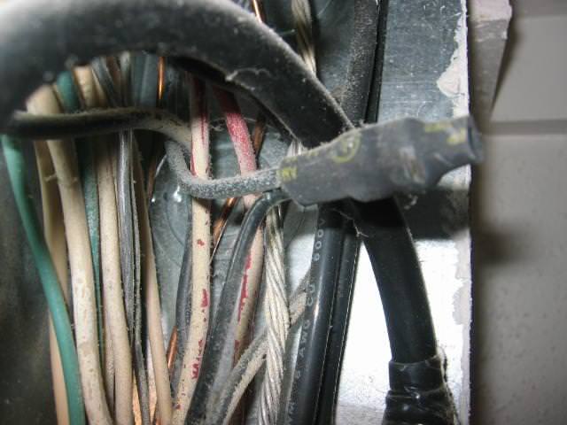

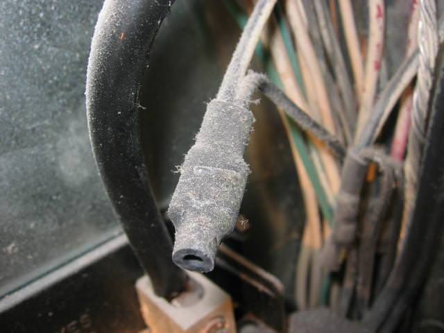

DonTx Posted August 3, 2006 Report Share Posted August 3, 2006 Did a late '70's condo yesterday with aluminum wiring. Feeder and branch wires had been "pigtailed" (well not really, read on) at the breakers and at the outlets. I've never seen this type of connector used to connect copper & aluminum. Can anyone tell me what type of connectors these are and if they are designed for use connecting copper & aluminum? Download Attachment: IMG_3461.jpg 52.81 KB Download Attachment: IMG_3463.jpg 43.66 KB They appear to me as the type of connector used to splice 2 wires into one or to splice two smaller wires with one larger one. Thanks, Quote Link to comment Share on other sites More sharing options...

hausdok Posted August 3, 2006 Report Share Posted August 3, 2006 Hi Donald, Those are the copalum connectors made by Amp. That's currently the preferred system. See this: http://www.inspect-ny.com/aluminum/alreduce.htm ONE TEAM - ONE FIGHT!!! Mike Quote Link to comment Share on other sites More sharing options...

DonTx Posted August 3, 2006 Author Report Share Posted August 3, 2006 Thanks Mike, Now, 1 more question. Since the wires are connected by inserting the copper splice and the aluminum branch wire side by side, is this an acceptable method? (see my pics above) All the connections I saw in this condo were made that way. I noticed the CPSC illustrations have the copper splice coming in at one end and the aluminum branch wire coming in at the other end of the connector. I also did not see any inhibiter or anti oxidant paste. (you could look into the open end of the connector and and see the co/al wires side by side) Thanks, Quote Link to comment Share on other sites More sharing options...
hausdok Posted August 3, 2006 Report Share Posted August 3, 2006 Hi, Check this link which shows them done the way you describe. http://tooling.tycoelectronics.com/copalum_home.stm I don't think it's necessary to use any anti-oxidation paste with these. The purpose of the paste is to prevent the wiring from oxidizing and loosening up. These connectors are crimped into the wire with a hand-held press tool and the connections cannot loosen up like connections that are twisted together or are held by a screw. At least that's my understanding of it. ONE TEAM - ONE FIGHT!!! Mike Quote Link to comment Share on other sites More sharing options...
