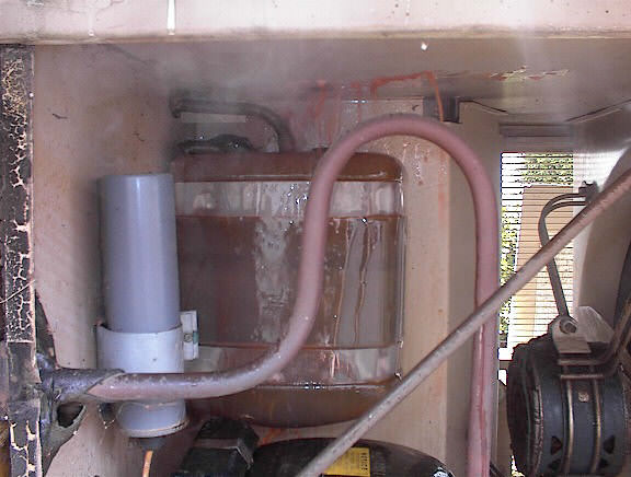

Jim Katen Posted February 11, 2004 Report Share Posted February 11, 2004 Originally posted by a46geo Jim, With the exception of the Lennox Pulse and Borg Warner glycol furnaces (both pretty much history), . . . George, I was unaware that Borg Warner made glycol units. Were they similar to the Amana ones? Here's a picture of the first Amana glycol unit I ever inspected. Turned up the thermostat, then took this picture. - Jim Katen, Oregon Download Attachment: Amana_Glycol.jpg 57 KB Quote Link to comment Share on other sites More sharing options...
a46geo Posted February 11, 2004 Report Share Posted February 11, 2004 No Jim, you are correct, it was Amana. Back in the 80's I worked for a company that sold York. Our second line was Amana. I stand corrected. My wife (whats-her-name) says my memory is terrible. I guess you just proved her right. However, your photo does bring back some BAD memories. George Quote Link to comment Share on other sites More sharing options...
