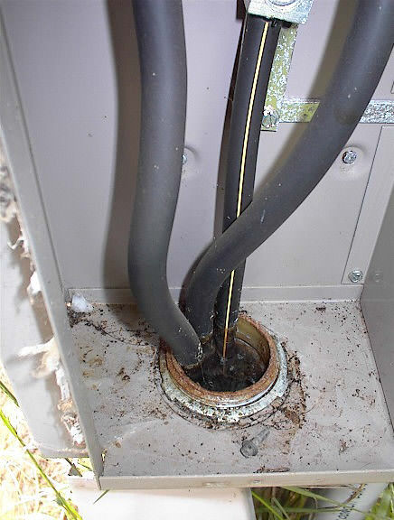

Renron Posted February 13, 2004 Report Share Posted February 13, 2004 Hey Guys! You all did such a great job on my last question, I'll try another one. A customer of mine has a Service panel where the feed is from the bottom. No problem yet, here is where it gets interesting. The bottom of the Service Panel is severely rusted, but no rust is present above 1" from the bottom of the Panel. I think water is comming in through the underground service (grey)PVC pipe when it rains hard. The house is down hill from the street, so if there is a crack or disconnection somewhere in the pipe from the drop water can travel downhill and then enter the service panel and run out on the side of the house. I personaly have seen this twice before living in Tahoe. My question is: What does code say about a drain or Pee trap type of arrangement prior to the Service Panel? Can a hole be cut in the PVC before the entrance to the panel and then protected by a screen? I know we don't do "code" checks but I would like to know (for myself) how to correct this problem without having to dig up the line all the way to the street ~400' away. Any thoughts? [:-banghead] I am proud to be a (newbie) Home Inspector! Thanks, Ron Quote Link to comment Share on other sites More sharing options...

Jim Katen Posted February 14, 2004 Report Share Posted February 14, 2004 Originally posted by Douglas Hansen . . . I used to think this was a rare problem. That you've seen it twice before makes me think we need the product these guys in Hayward are making. I see it up here now & then when the meter is downhill from the street. It's sort of like an artisian well effect. Note the attached pictures. On this house, I speculated that the culprit was rainwater entering the conduit way up the pole, near the transformer. - Jim Katen, Oregon Download Attachment: Martin 01.jpg 61.8 KB Download Attachment: Martin 05.jpg 62.4 KB Quote Link to comment Share on other sites More sharing options...
Brian G Posted February 14, 2004 Report Share Posted February 14, 2004 I would assume the set-up in Jim's photos is what Chad was describing, more or less. Forgive me all, but that arrangement looks purely bone-headed to me. Why in the world wouldn't you simply install a weatherhead and a drip loop to keep the rain out? If done at installation the extra labor and expense would be minor, at worst. Douglas, I have no desire to pester you, so I promise to not belabor the point beyond this post about the PVC. But I must say that I think you're letting the electricians off too easy by conceding out-of-hand that water-tightness is not possible. Isn't it reasonable assume that it is more difficult to keep water "In" under typical household pressures than to keep it "Out" under any naturally occuring pressures? If asked before this discussion, I would have said that water-tight PVC lines were not only possible, but a relatively minor and common accomplishment. I can see where you might have unavoidable condensation, and the inherent wisdom of planning for a leak by requiring water-resistant wiring, but beyond that I'm puzzled. My apologies, I'm hard-headed. Brian G. I Blame It on My Genes, My 5 Year-Old is Even Worse Quote Link to comment Share on other sites More sharing options...
