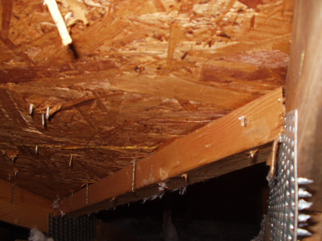

E. Burns Posted February 20, 2004 Report Share Posted February 20, 2004 How do you like these exposed nails these were all over the roof? This is what happens when shingles are not nailed properly. The remainder of the shingles are ready to blow. House about a block from the beach. Download Attachment: P1010018.jpg 144.7 KB Quote Link to comment Share on other sites More sharing options...

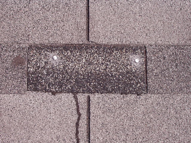

E. Burns Posted February 20, 2004 Report Share Posted February 20, 2004 Brian how come you didn't tell me about the previous wrong picture. Here is the correct one, sorry. Download Attachment: P1010018.jpg 157.42 KB Quote Link to comment Share on other sites More sharing options...
Erol Kartal Posted February 21, 2004 Report Share Posted February 21, 2004 If there are too many exposed nails isn't the roof considered defective? I realize the words 'too many' are subjective, but when do you stop recommending caulk and start looking at the potential severity of the problem? Erol Kartal Quote Link to comment Share on other sites More sharing options...
