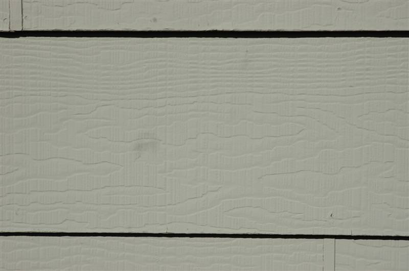

Robert Jones Posted October 14, 2006 Report Share Posted October 14, 2006 Hello all, I cannot pin down the name of this siding and am hoping one of you may be able to assist me. It is wrapping a house built in 1976, obviously composite board. Name anyone? Thanks for your help. Download Attachment: siding ID (Medium).JPG 49.62 KB Quote Link to comment Share on other sites More sharing options...
Jim Katen Posted October 14, 2006 Report Share Posted October 14, 2006 Originally posted by bootsan Hello all, I cannot pin down the name of this siding and am hoping one of you may be able to assist me. It is wrapping a house built in 1976, obviously composite board. Name anyone? Thanks for your help. Download Attachment: sidingID(Medium).JPG 49.62 KB The photo won't open. Rename it without any spaces. - Jim Katen, Oregon Quote Link to comment Share on other sites More sharing options...
Robert Jones Posted October 14, 2006 Author Report Share Posted October 14, 2006 Sorry about that. This pic should work. Thanks Rob Download Attachment: sidingID (Medium).JPG 49.63 KB Quote Link to comment Share on other sites More sharing options...
Robert Jones Posted October 14, 2006 Author Report Share Posted October 14, 2006 Just in case. Download Attachment: sidingID.JPG 49.62 KB Quote Link to comment Share on other sites More sharing options...
Jim Katen Posted October 14, 2006 Report Share Posted October 14, 2006 Originally posted by bootsan Just in case. Download Attachment: sidingID.JPG 49.62 KB Georgia Pacific Catawba or Masonite Woodsman. - Jim Katen, Oregon Quote Link to comment Share on other sites More sharing options...

Gerry Beaumont Posted October 15, 2006 Report Share Posted October 15, 2006 Hi to all, The best refernce site for composite siding is run by David Cohen from Portland Oregon. www.sidingsolutions.com BTW David also publishes a very good handbook on the subject for very short money, highly recommended. Regards Gerry Quote Link to comment Share on other sites More sharing options...
