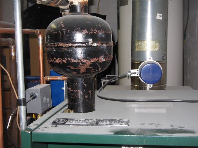

Neal Lewis Posted October 24, 2006 Report Share Posted October 24, 2006 Brand new steam boiler has a welded steel bulb installed directly in the riser off the top of the boiler. What is the purpose of this thing?? Download Attachment: IMG_4368.JPG 398.92 KB Quote Link to comment Share on other sites More sharing options...
chicago Posted October 24, 2006 Report Share Posted October 24, 2006 It looks to me as if it is older than the boiler and was jury rigged from something else to serve as a cast iron reducer.most likely serves no other purpose. Quote Link to comment Share on other sites More sharing options...
Rob Amaral Posted October 24, 2006 Report Share Posted October 24, 2006 No idea. Holahan-it and let us know. Seems to me that it would cause some steam to prematurely condense due to the surface area being uninsulated. But why..? Quote Link to comment Share on other sites More sharing options...

Bill Kibbel Posted October 24, 2006 Report Share Posted October 24, 2006 Replacement boilers usually contain a much smaller volume of water then the monsters they're replacing. The large internal volume of old boilers helped slow down the steam, allowing water droplets (like a mist) to drop out. Many installers of replacement systems will oversize the near-boiler piping to act like an external steam separator. I'm guessing that is the intention of this device, after they used it for bowling down the driveway. Quote Link to comment Share on other sites More sharing options...
Jim Morrison Posted October 25, 2006 Report Share Posted October 25, 2006 Sorry to be late jumping in here, but you get the idea. It's meant to remove condensate from wet steam. Jim Morrison Quote Link to comment Share on other sites More sharing options...
