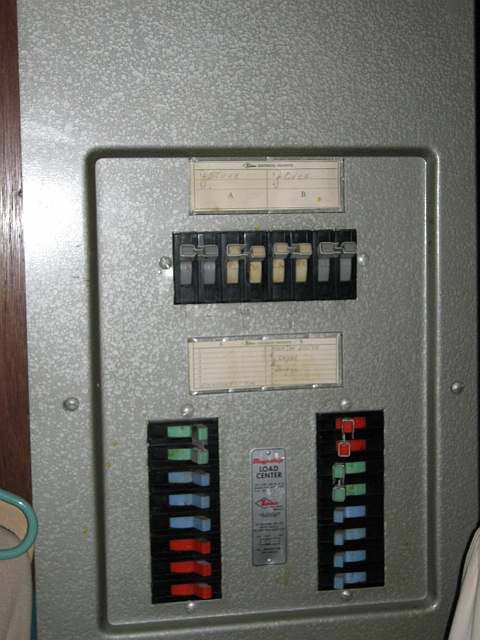

strawman Posted November 15, 2006 Report Share Posted November 15, 2006 Here I go...... On my very first paid inspection. Cool, at least I'm not bored. What do you all think of this. Needin' some insight for my own edification. Recommended to client to have professional electrician evaluate and upgrade as needed.[:-graduat Download Attachment: IMG_0333.JPG 43.4 KB Download Attachment: IMG_0334.JPG 29.79 KB Download Attachment: IMG_0335.JPG 39.99 KB Download Attachment: IMG_0336.JPG 33.68 KB Download Attachment: IMG_0337.JPG 37.94 KB Quote Link to comment Share on other sites More sharing options...
Mark P Posted November 15, 2006 Report Share Posted November 15, 2006 Rough 1st inspection – geeezzz. It won't be me who does the edification – cuz I ain’t never seen one of them dare contraptions- but I'm eager to see what the electric-gurus have to say. It is stuff like this that makes TIJ so awesome, everyone benefits – everyone learns from each other questions. I have often returned from an inspection, posted a picture and question and usually receive helpful info while I’m sitting writing the report. Quote Link to comment Share on other sites More sharing options...
Mark P Posted November 15, 2006 Report Share Posted November 15, 2006 And why are all the breakers different colors, blue, red, green? Is that some indication of the amperage? Quote Link to comment Share on other sites More sharing options...
Jerry Simon Posted November 15, 2006 Report Share Posted November 15, 2006 Originally posted by AHIS And why are all the breakers different colors, blue, red, green? Is that some indication of the amperage? Yes...if memory serves me, green is 30-ampere, red is 20, and blue is 15 (I may have blue & red reversed...hate my over-50 memory). Quote Link to comment Share on other sites More sharing options...

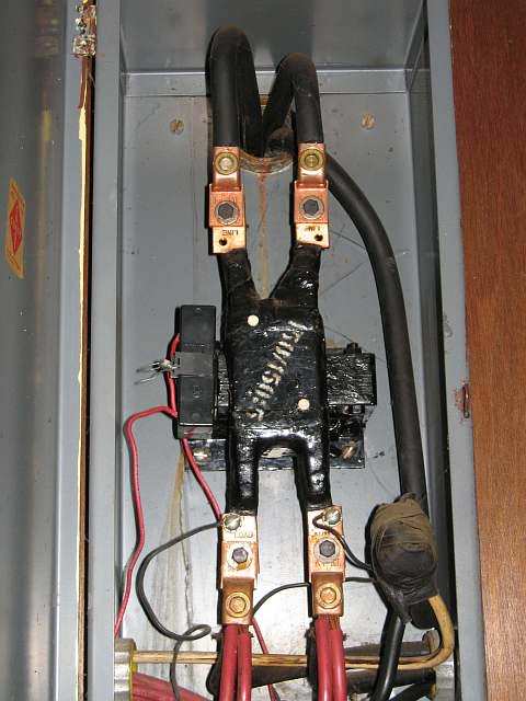

pi Posted November 15, 2006 Report Share Posted November 15, 2006 I'd have to see cover off right panel but I think (that usually means trouble) all may be well. That is a little transformer under the service conductors. I saw one of these set ups a long time ago, spent a long time on it checking what went where, sizes etc., and it was OK. You are right on for sending it to a shocker though if you are not sure. Try to be there when he is there and learn what you can. Why update if it is functioning as intended with no hazards observed. Quote Link to comment Share on other sites More sharing options...

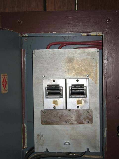

hausdok Posted November 16, 2006 Report Share Posted November 16, 2006 Hi, That's a Magnatrip. Besides the fact that it's a Zinsco and is considered the Corvair of the electrical world, it's about 40 years old and it's time to replace it. Yep, they'll color coded and, yep, they do come with single main disconnects.......sometimes. Most of the older Magnatrips have copper bus bars and then somewhere around the mid-60's they went to an aluminum bus. Do you remember what this one had? ONE TEAM - ONE FIGHT!!! Mike Quote Link to comment Share on other sites More sharing options...

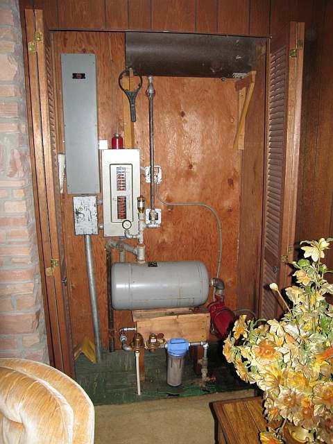

strawman Posted November 16, 2006 Author Report Share Posted November 16, 2006 Yeah, I've been lucky. Here's a pic of the heating sys. and yup the gorge is a beaut. not near enough time to play, but when I can. thanks fer askin'[][] Download Attachment: IMG_0330.JPG 51.03 KB Quote Link to comment Share on other sites More sharing options...
hausdok Posted November 16, 2006 Report Share Posted November 16, 2006 Huh? That's a second Magnatrip. What was that one for? OT - OF!!! M. Quote Link to comment Share on other sites More sharing options...
strawman Posted November 16, 2006 Author Report Share Posted November 16, 2006 This is the secondary water heater, and electrical controls for each radiator in every room of the home. There was one thermostat but each radiator was electricly controlled....Hey, this was my first inspection and at this point I was feeling a bit puzzled. The local plumber who has worked on the system for years verified that every little thing works great and the house felt very evenly heated. Quote Link to comment Share on other sites More sharing options...
kurt Posted November 16, 2006 Report Share Posted November 16, 2006 It all looks a little strange; whether or not it heats evenly, well, it probably does, but I'd have to say a little something about the system being a "homemade" system that probably has it's idiosyncracies. IOW, it doesn't plug into any industry standard I'm familar with. Try to keep it in mind when writing reports that someday you may have to justify what you said in court. Homemade systems worked on by the local plumber usually don't "hold up in court". (Also, that green tile looks like 9x9 asbestos; was it?) Quote Link to comment Share on other sites More sharing options...

strawman Posted November 16, 2006 Author Report Share Posted November 16, 2006 Yup, this is one good place to fill up on info. I did atttempt to cover myself on both of these "unique" systems in my report by pointing out that they were indeed unusual and, by select language, I just slightly avoided excluding them altogether. I recommended in both cases to consult with lic. electrician and lic. plumber. And I thank you Kurt, for the heads up on asbestos tile. Made mention of it in the report and at the inspection. and thank you James for the encouragement. "It's not our differences that divide us, it's our inability to recognize, accept, and celebrate those differences." Quote Link to comment Share on other sites More sharing options...
Jim Katen Posted November 17, 2006 Report Share Posted November 17, 2006 Originally posted by pi I'd have to see cover off right panel but I think (that usually means trouble) all may be well. That is a little transformer under the service conductors. I saw one of these set ups a long time ago, spent a long time on it checking what went where, sizes etc., and it was OK. While I've never seen ones that looked like this, it might be a current transformer. The small wires would lead to the meter which would read the power consumption at a fractional level. You are right on for sending it to a shocker though if you are not sure. Try to be there when he is there and learn what you can. Why update if it is functioning as intended with no hazards observed. The fact that it's Zinsco equipment is enough of a hazard. This was terrible equipment and is nearly universally reviled in the electrical world. Just because it isn't actually on fire when you're looking at it doesn't mean that it's ok. How do you know that it's functioning as intended? Can you see whether or not there are scorched spots on the bus bars? (extremely common with the Zinsco design) Can you see whether or not the breakers will trip when they should? (a common fault (heh, heh) of Zinsco breakers) Can you see that the bus connections arc on certain breakers when they draw a high load? Zinsco equipment doesn't deserve the benefit of the doubt. - Jim in Oregon Quote Link to comment Share on other sites More sharing options...
