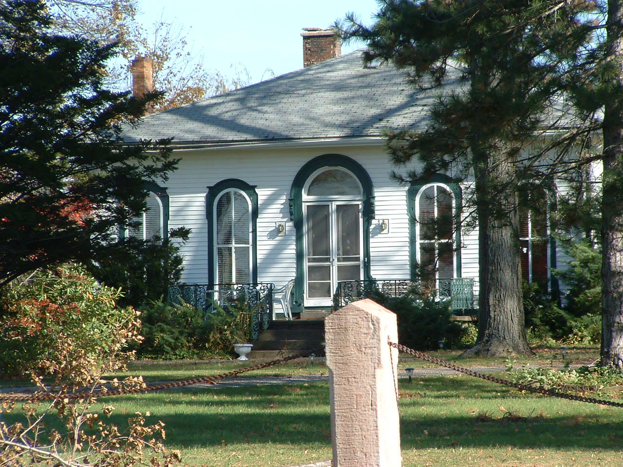

Chad Fabry Posted December 3, 2006 Report Share Posted December 3, 2006 Anyone else have pics of single storey italiantes? This is the only one I've ever seen Download Attachment: DSCF0002.JPG 335.84 KB Quote Link to comment Share on other sites More sharing options...
kurt Posted December 3, 2006 Report Share Posted December 3, 2006 I may be out of it, but I wouldn't call that an Italianate; it's a single story frame, hip roof, w/Italianate inspired window details. It's probably a nice house, but sort of in the same bin as the early 20th century combinations of differing architectural styles. Quote Link to comment Share on other sites More sharing options...
Chad Fabry Posted December 3, 2006 Author Report Share Posted December 3, 2006 The doors,the trim around the doors,the sash, the window openings,the window size et al are quite italianate. I do concede the lack of corbels. There was no one there when I knocked; the next time I pass I'll try again to get some history. Quote Link to comment Share on other sites More sharing options...
kurt Posted December 3, 2006 Report Share Posted December 3, 2006 It's really about the corbels; after that, the roofline is (kind of) American Style Italianate, but the lack of corbels puts a strange proportion on it. The Breakers in Newport has a "hip roof", but it doesn't figure prominently in the appearance like this house. Bet it's nice inside. Quote Link to comment Share on other sites More sharing options...
Bill Kibbel Posted December 3, 2006 Report Share Posted December 3, 2006 It wants to be an Italianate when it grows up! Anyone else have pics of single storey italiantes (sp)? In my realm, the only single storey ones are buildings secondary to the main house or small churches/chapels. I can see that the siding projects beyond the surface of the trim, indicating a recent NTE attack (Nefarious Tupperware Encapsulation). This usually results in the hacking-off of bracket thingies. My second guess is that there originally was an upper full or half storey that was lost and then replaced with the hipped roof. Adaptive re-use of a Gothic Revival carriage house: Quote Link to comment Share on other sites More sharing options...

Chad Fabry Posted December 8, 2006 Author Report Share Posted December 8, 2006 The house in the picture I posted lost its second storey and its cupola to fire about 75 years ago. Well, there goes the "visionary" builder /architect theory. Quote Link to comment Share on other sites More sharing options...
kurt Posted December 9, 2006 Report Share Posted December 9, 2006 Tragic. So, an Italianate indeed, modified by time. Quote Link to comment Share on other sites More sharing options...
