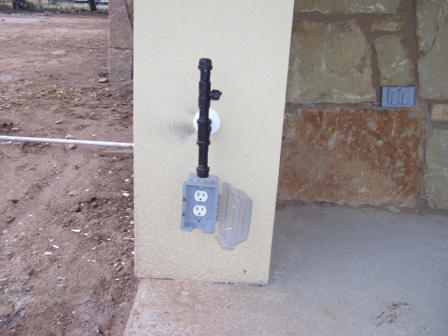

JesseWBryant Posted December 7, 2006 Report Share Posted December 7, 2006 Hello all. I can't recall , if any, the distance required between a gas line and an outlet. The line in the picture is for a future outdoor grill. The outlet is positioned about 4"-5" away from the drip leg of the gas line. I tried looking through the forums briefly (working on the report now) but have not found anything specific. I will continue to leaf through the IRC but if anyone has an idea, that would be great. Thanks. Download Attachment: 100_4844.gif 195.8 KB Quote Link to comment Share on other sites More sharing options...
sbrooten Posted December 7, 2006 Report Share Posted December 7, 2006 I can't find any prohibition in either the electrical code or the IRC for this installation. Doesn't mean (to paraphrase an old song) that "I'm lookin' in all the right places." Quote Link to comment Share on other sites More sharing options...
Jim Katen Posted December 7, 2006 Report Share Posted December 7, 2006 Originally posted by JesseWBryant Hello all. I can't recall , if any, the distance required between a gas line and an outlet. The line in the picture is for a future outdoor grill. The outlet is positioned about 4"-5" away from the drip leg of the gas line. I tried looking through the forums briefly (working on the report now) but have not found anything specific. I will continue to leaf through the IRC but if anyone has an idea, that would be great. Thanks. It's not a problem. - Jim Katen, Oregon Quote Link to comment Share on other sites More sharing options...

Scottpat Posted December 8, 2006 Report Share Posted December 8, 2006 Think of this like a gas stove or cooktop inside of a home. You need an outlet to plug in the electronics of the device. Most likely it will be about the same. Quote Link to comment Share on other sites More sharing options...

PAbernathy Posted December 9, 2006 Report Share Posted December 9, 2006 While it is not attractive to look at, their is no violation here. Quote Link to comment Share on other sites More sharing options...
