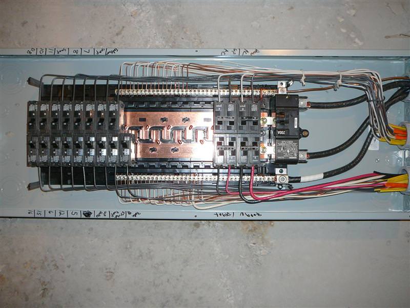

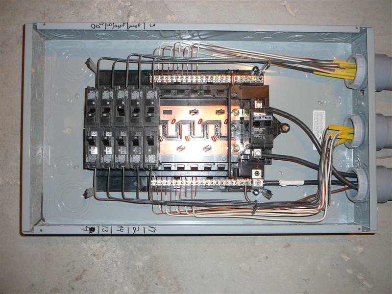

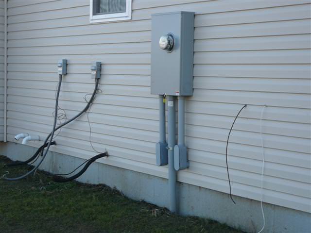

Mark P Posted January 10, 2007 Report Share Posted January 10, 2007 This should be an easy question, but for some reason I'm double guesing myself. New construction single family home: 2 electrical panel boxs next to each other 1 is 200amp the other 100amp and is not a sub. So this means the house has 300amps, right? Also new construction should have AFI for the bedroom breakers right. Download Attachment: 100amp.JPG 89.03 KB Download Attachment: 200amp.jpg 89.58 KB Download Attachment: outside.jpg 44.39 KB Quote Link to comment Share on other sites More sharing options...
ozofprev Posted January 10, 2007 Report Share Posted January 10, 2007 Strictly speaking, I would state it as having a 100A service and a 200A service. Sure, that gives you 300A, but it's not on one service, so that would potentially be misleading. It would help the client if you indicate the section(s) of the house served by each service. That might also help you understand why they are doing this - how big is the house? Is there a special need - bowling alley, grow-room, film studio??? And yes, AFI in the bedrooms - even though the debate as to their worth is ongoing... Originally posted by AHIS This should be an easy question, but for some reason I'm double guesing myself. New construction single family home: 2 electrical panel boxs next to each other 1 is 200amp the other 100amp and is not a sub. So this means the house has 300amps, right? Also new construction should have AFI for the bedroom breakers right. Quote Link to comment Share on other sites More sharing options...

Mark P Posted January 10, 2007 Author Report Share Posted January 10, 2007 Thnak you, I'll list it as two seperate services and not as a grand total. The house is around 3500 sqft + an unfinished basement with nothing special at all, except that it has seperate furnaces and a/c for each floor. I don't know what it was wired this way - room to expand I guess. Oh, the pictures are sideways for some reason not the boxs. Quote Link to comment Share on other sites More sharing options...
Bain Posted January 10, 2007 Report Share Posted January 10, 2007 The incoming service is likely rated at 400 amps. Looks to me like the electrician wanted to save a couple of hundred bucks by not installing two 200-amp panels, which is the typical set up around here. Quote Link to comment Share on other sites More sharing options...
Mark P Posted January 10, 2007 Author Report Share Posted January 10, 2007 I can't list the homes amperage as 400, when the two main breakers are 100 and 200, or I might be spendig a couple of hundered bucks having the smaller panel replaced if the buyer were to get nasty. Quote Link to comment Share on other sites More sharing options...
bandag Posted January 11, 2007 Report Share Posted January 11, 2007 Looks like a rather neat wiring job, but I can't say the same for all that junk on the outside wall of the house. Quote Link to comment Share on other sites More sharing options...
Jim Katen Posted January 15, 2007 Report Share Posted January 15, 2007 Originally posted by AHIS This should be an easy question, but for some reason I'm double guesing myself. New construction single family home: 2 electrical panel boxs next to each other 1 is 200amp the other 100amp and is not a sub. So this means the house has 300amps, right? Yes. You're right. Be aware that it's possible that the meter and laterals are capable of providing 400 amps. The service is limited to 300 amps by the two main breakers in your pictures. Also new construction should have AFI for the bedroom breakers right. Yes, if that town has adopted 210.12(B). No, if they haven't. I understand that there are some places that have snipped that section out of their code. - Jim Katen, Oregon Quote Link to comment Share on other sites More sharing options...
Jim Katen Posted January 15, 2007 Report Share Posted January 15, 2007 Originally posted by ozofprev Strictly speaking, I would state it as having a 100A service and a 200A service. Nope. A single service can have multiple main panels. It can even have multiple meters. As a general rule, a building can only have one service. There are several exceptions to this rule, but none of them apply to dwellings. Read all about it in 230.2. - Jim Katen, Oregon Quote Link to comment Share on other sites More sharing options...
Jim Katen Posted January 15, 2007 Report Share Posted January 15, 2007 Originally posted by Bain The incoming service is likely rated at 400 amps. Looks to me like the electrician wanted to save a couple of hundred bucks by not installing two 200-amp panels, which is the typical set up around here. What probably happened is that, at the design stage or at the plan review stage, someone calculated that this house would require a 300-amp service. (Note the rough-in for two AC units. This might be a big house.) So that's what the electrician installed. It's probably more than ample. - Jim Katen, Oregon Quote Link to comment Share on other sites More sharing options...
Nolan Kienitz Posted January 15, 2007 Report Share Posted January 15, 2007 Don't forget to note having PVC painted for UV protection. Required in Texas, but not sure about your area. Quote Link to comment Share on other sites More sharing options...

PAbernathy Posted February 15, 2007 Report Share Posted February 15, 2007 This is a single service, the meter enclosure is a 320A Conin. and a 400A Non-Cont. enclosure. Chances are the service calculation came up as under 300A or they used the optional method to decrease it below 300A or simply to effect the installation, only the electrician knows this. AS for sizing this service you really should deal in Capacity and Rating......this enclosure will have a capacity based on the combined components of the system based. Now, you have to post the size of the SE Conductors, Panel Rating, OCPD Rating and (2) others we will throw out......because it is latteral and you can't see them. This service has a rating of 300A based on the weakest link designation....based on what he has posted....the capacity could be different but in this case 300A based on the enclosure ratings has to govern here without the other information. Check out my basic video on this....simplified -http://www.theelectricalguru.com/video.html Also if new construction make sure they re-identify those while conductors going to the breakers...... I did not look at the images any furthur than those issues. Quote Link to comment Share on other sites More sharing options...
