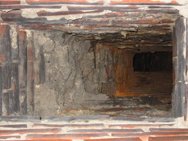

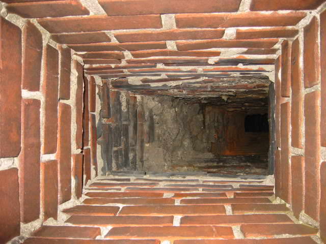

Rob Amaral Posted January 13, 2007 Report Share Posted January 13, 2007 Mr Kibble is a man after my own heart. He gave a talk up here in RI this fall and had a photo of his 'gear'. I'm using the same darn set-up! Cam shots into heating appliance breeches through the barometric damper...Been there, done that, Bill. Chimney-voodoo is hugely appreciated by clients and saves time for them. Using the cam to document mortar loss in unlined flue passages, chimney tops, cracks, collapsed stuff.. My biggest 'tool' is a small circular mirror from CVS beauty dept.. Guys not using mirrors or strong flashlights are simply 'missing stuff' a lot. Oh yeah, use your knees...(Bend down, look...). Some guys out there can't bend anymore... ! Or use the mirror instead..! Quote Link to comment Share on other sites More sharing options...
