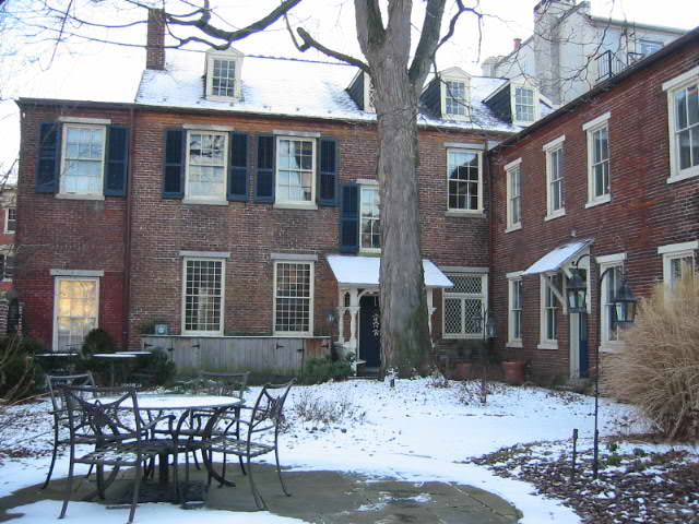

Twice in the past week, I've had houses with Plexiglas screwed in place over bedroom windows. The first was a 60's ranch that had them screwed to the exterior. Yesterday I had a 7,000 square foot (including additions) 1833 Federal style house that had Plexiglas screwed in place at the interior of every single double hung window on the first and second floors. The place was a nightmare to heat, but the owner didn't want to mar the exterior with storm windows. The windows on the unheated third floor weren't covered with Plexi, but they did have the sashes screwed closed. Over 40 windows were inoperative!
The inspection was for the homeowner, who is considering putting the place up for sale. When I pointed out the glaring problem of no emergency egress, he proudly pulled out a fire ax. He said he keeps one in every bedroom, and when they have overnight guests, he shows them where the ax is and what it's to be used for. I have to admit, I was speechless.
